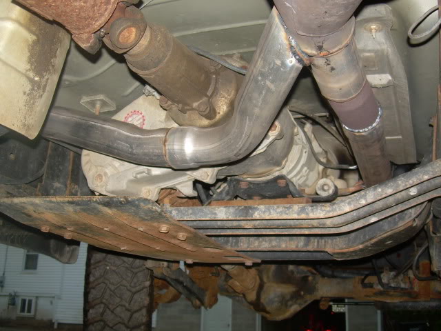

this is my custum y pipe , i do have cats now though Name:  trucks004.jpg
No pic, did you mean to have one?
Old Jan 19, 2011 | 01:47 PM
  #106
offroadjosh's Avatar
offroadjosh
Joined: Sep 2009
Posts: 2,072
From: Montana
I see one..
