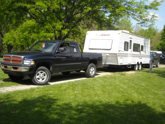

Oh, I'd like to see a pic of your camper! Here is my dad's:
Its a 25ft Jayco.

Here's some pics. Don't have too many yet as I just got it at the end of the season last year. Only made it out 5-6 times with it so far.

Oh man, thats nice. You wanna trade?
