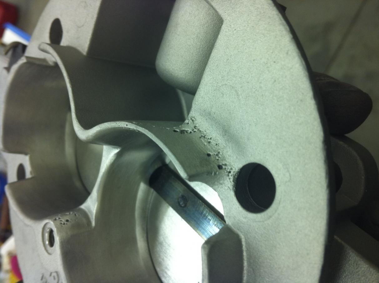

I ordered the FI air gap kit and throttle body from Hughes and after looking over the parts noticed the throttly body had been cracked and rewelded. The weld left somthing to be desired in my opinion. The (work) done to it was not really up to what I was expecting. The "Polished air horns and throttle bores" look to have been hit with a sanding drum on a die grinder and maybe smothed a little after.

Attached Thumbnails Hughes engines customer service problem?-iphone-4-pics-119.jpg

I had zero issues with hughes engines. That doesnt look to be welded but rather a casting issue to me. In any event they should have sent it out looking like that.

My Hughes pan came in bad shape. Sent me a replacement no problem. The first one should have never left IMHO, but at least they made it right. I too agree that looks like a casting defect, rather than being welded. In any case, If I were you I would just send it back for replacement. My replacement pan looked 50x better which makes me wonder if the replacement was hand Picked and checked before shipped. Wish ya luck

That looks like porosity. It's a casting defect. You see it all the time in machine shops that machine raw castings. I would send it back.

What you see can be epoxied and sanded but what can't you see? You shouldn't pay for quality and get junk!

I do tig weld and it is hard to see in the pic but you can see where it diped out beside the weld from the electrode.
