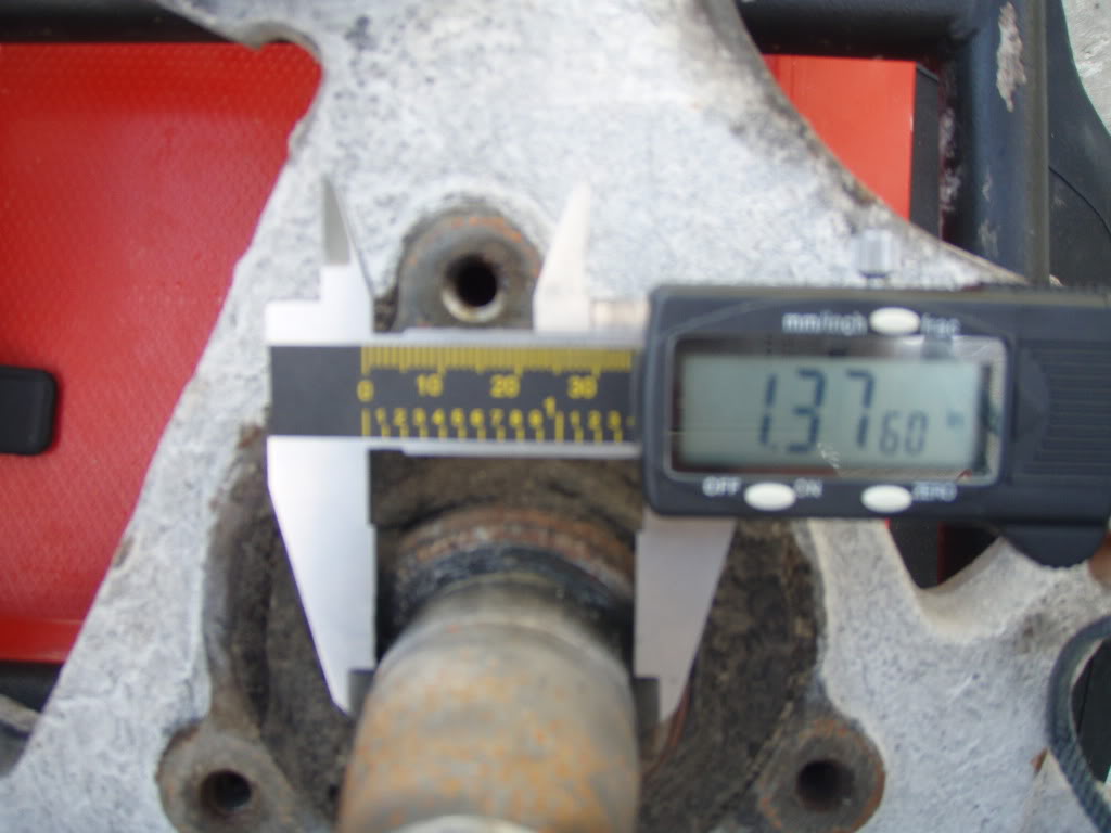

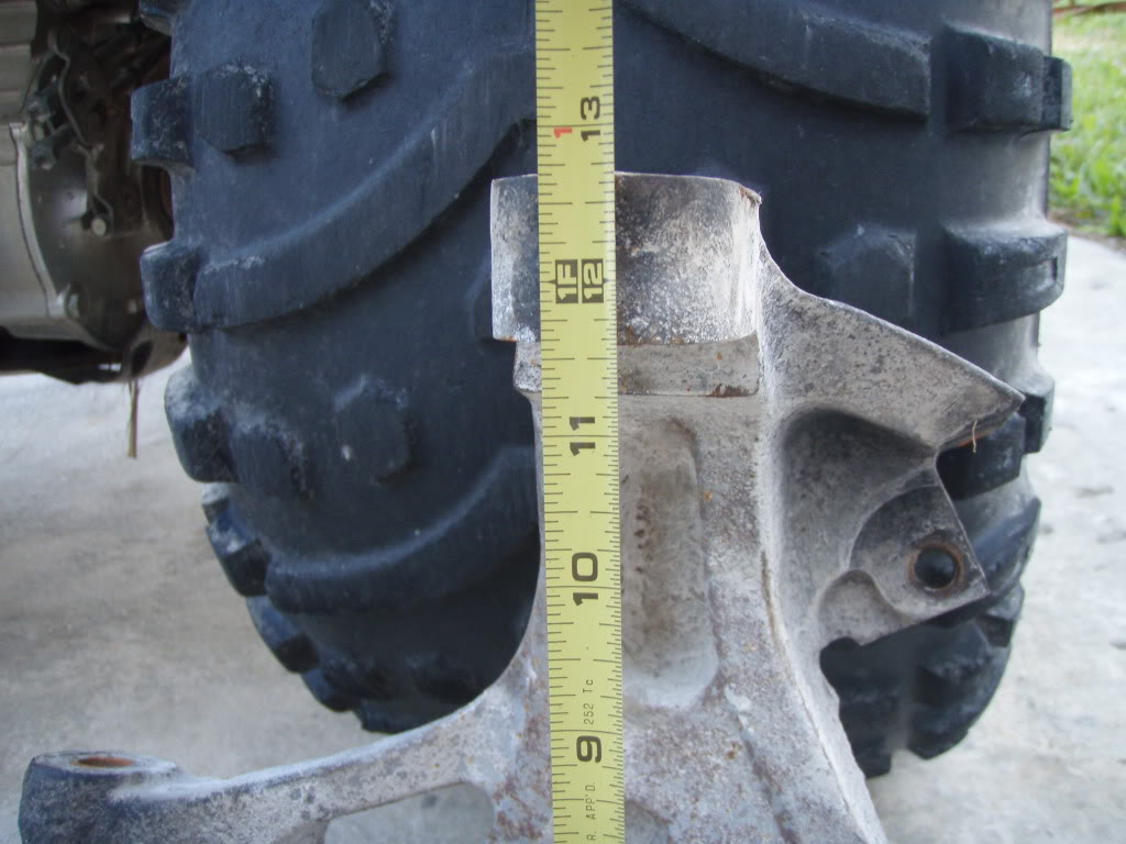

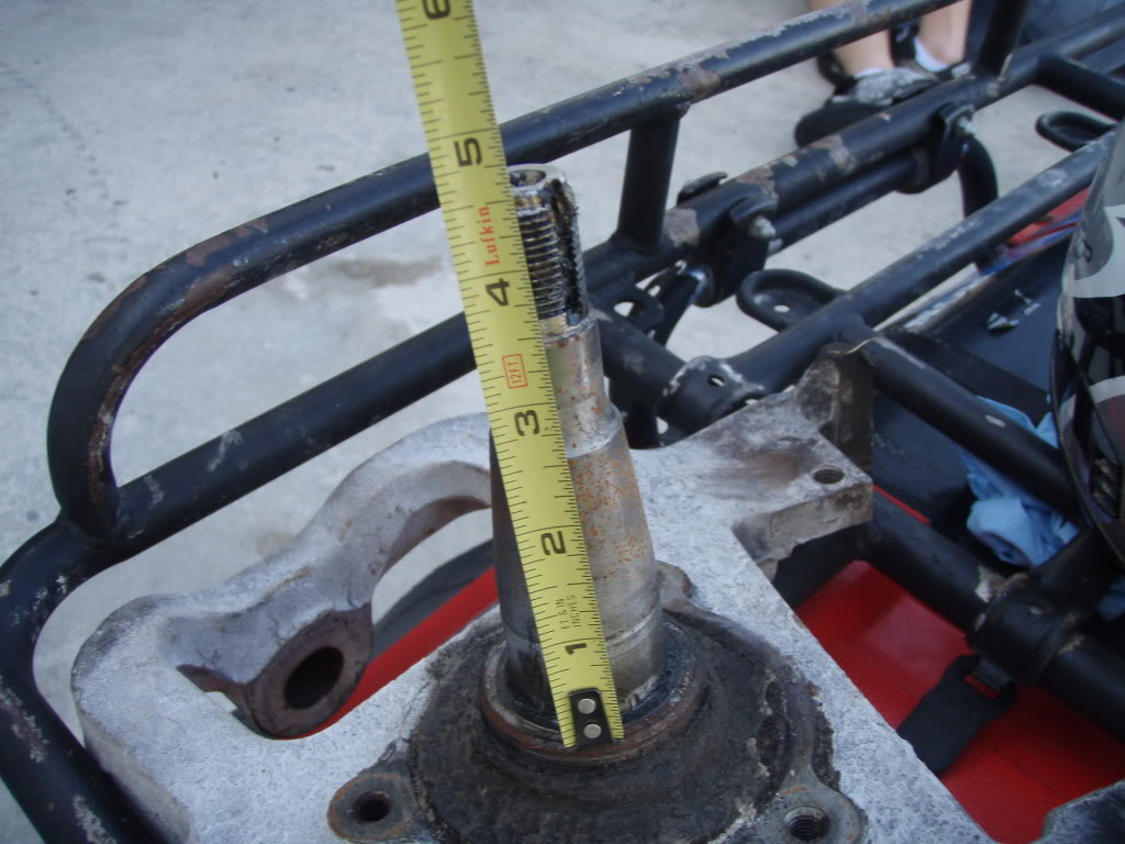

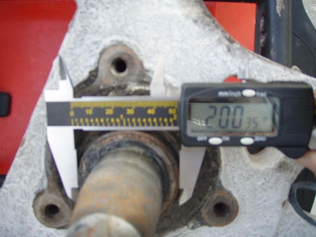

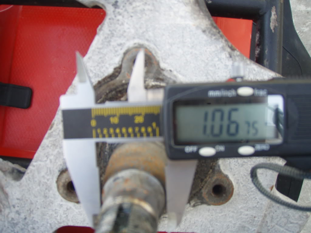

I have a question, does anyone know if the 1500 spindles are same as 2500? I want to run a 3 in lift spindle, and have an opportunity to get a set for cheap. Just not sure if they will fit beefy. Preciate any input available.

pretty sure they are the same but if you measure yours up I can take the ones I have sittin in the shed and give you the same measurements back to verify they are the same

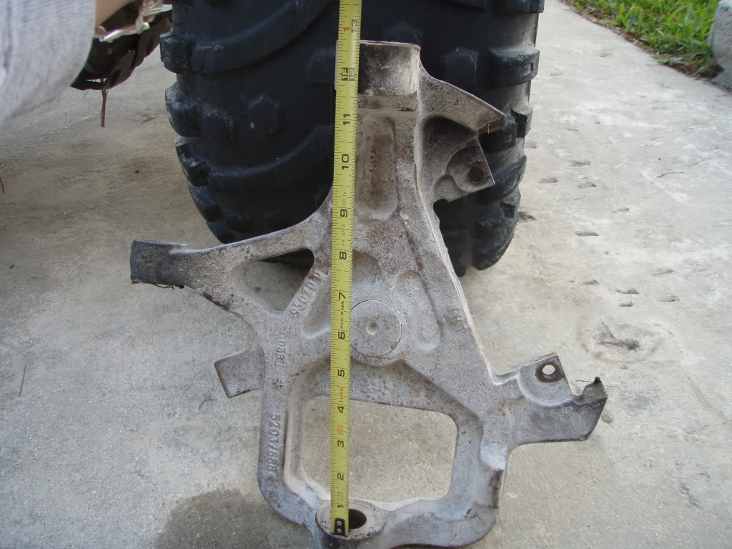

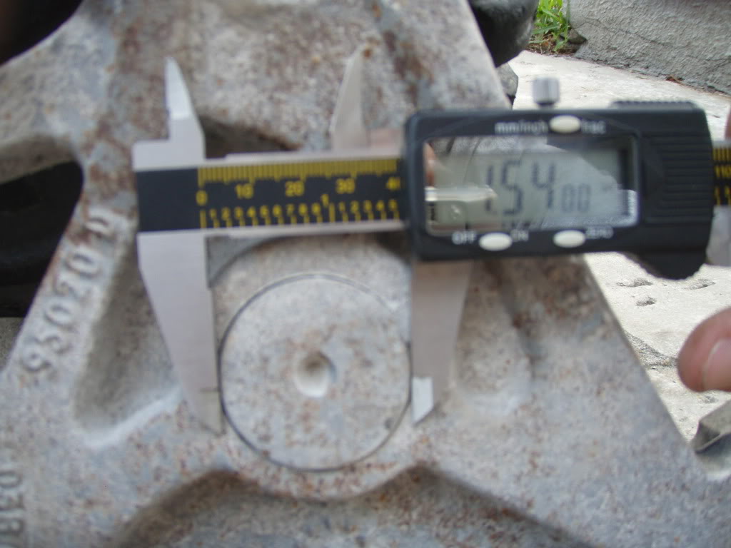

Red, that would be awesome, can you verify the # of bolts holding the hub onto the spindle, and measure the hub seat diameter? Also the rise from the upper edge of hub seat to the lower edge of upper ball joint mount. Thanx! I will measure mine 2morow 2 verify.

Here some measurements, sorry it took so long been really busy and then my dad moved my spindles when he decided to organize the shed.

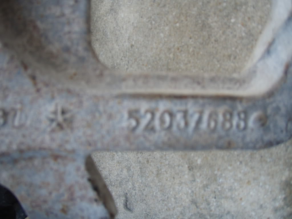

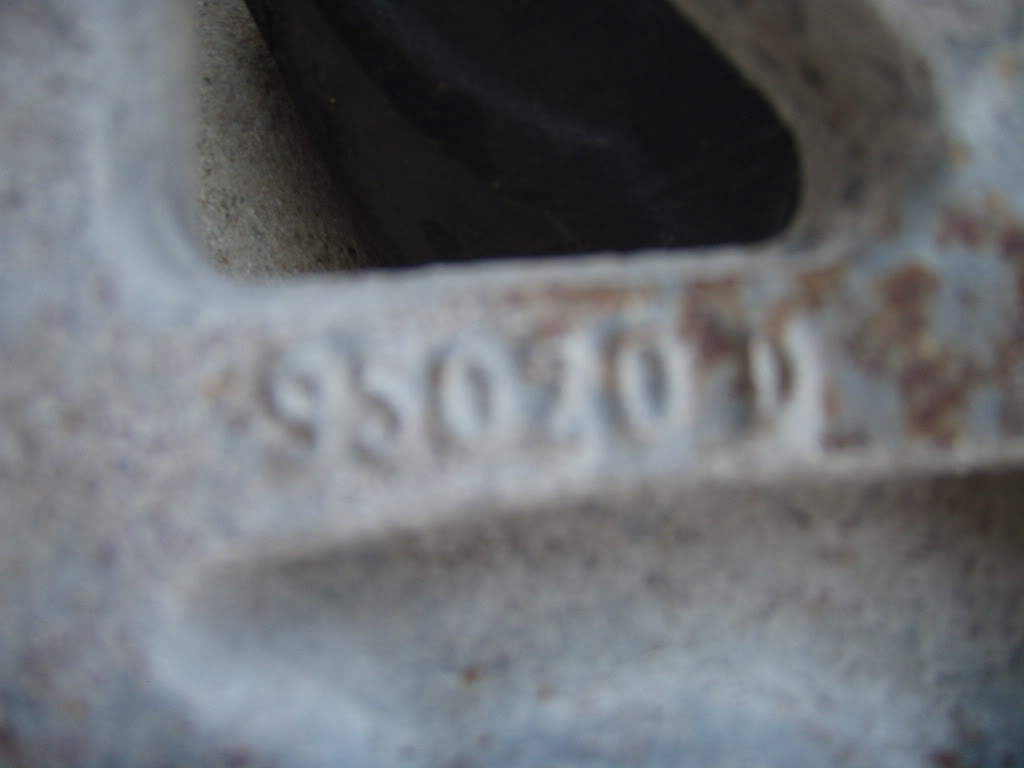

Also some numbers that were stamped on the spindle
