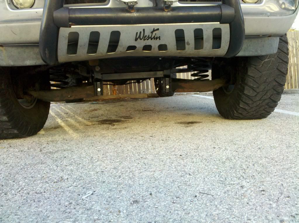

Yea I am def blessed that my ttruck was very well maintained by the previous owners. It runs perfect, and is very clean underneath. Things came apart very easily. The oly thing seized up is the inner bolt on the passenger side tie rod coupler. (Which is why I haven't finished aligning it). I am going to get that smoothed out this weekend.
Btw the rubbing was a piece of my fenderwell that I apparently did not cut all the way off. Lol. Pulled that off and straightened out the inner fenderwell with a hammer, and viola, almost all of my rubbing is gone. Still gtonna lift it a lot more tho!
Just wanted to post a completed underneath shot from the front end. She's sitting in a grosss paking spot, but that mes is not from my truck lol.

It looks like the camber is off a little bit, like the top of the tires are leaning out away from the truck more than the bottom.
Even if I'm wrong, it wouldn't hurt to do some measuring to ensure you don't wear out the outside edge of the tires prematurely.
If it is off then you could probably fix it by making the drop bracket a little bit wider to push the bottom of the tires out.

Thje camber is off a alil bit, but that camera angle in that pic is weird, the top of the tire is actually in a lil on the passenger side. But the toe is the main problem. Def need to fix both this weekend.

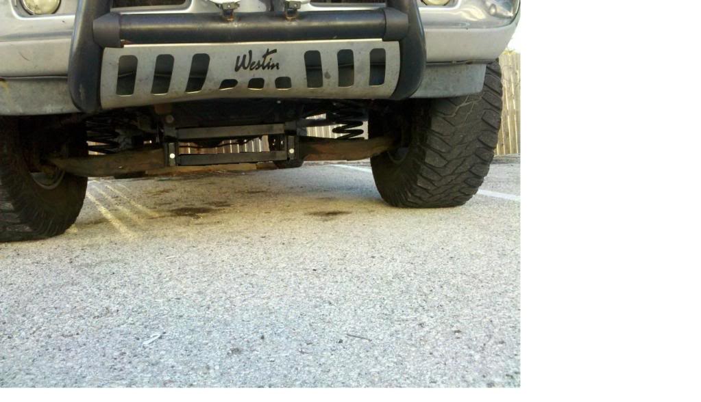

Lift cups worked great, upper control arms are to short, and it throwing my camber off bad, as you can see. We are extending the upper control arms a full inch to give me good camber, and ball joint angle. Will be posting pics as work comenses today. Should be pretty smooth sailing.

I'm glad you caught that camber issue. It would suck to wear those tires out faster than they should due to the price of them.
