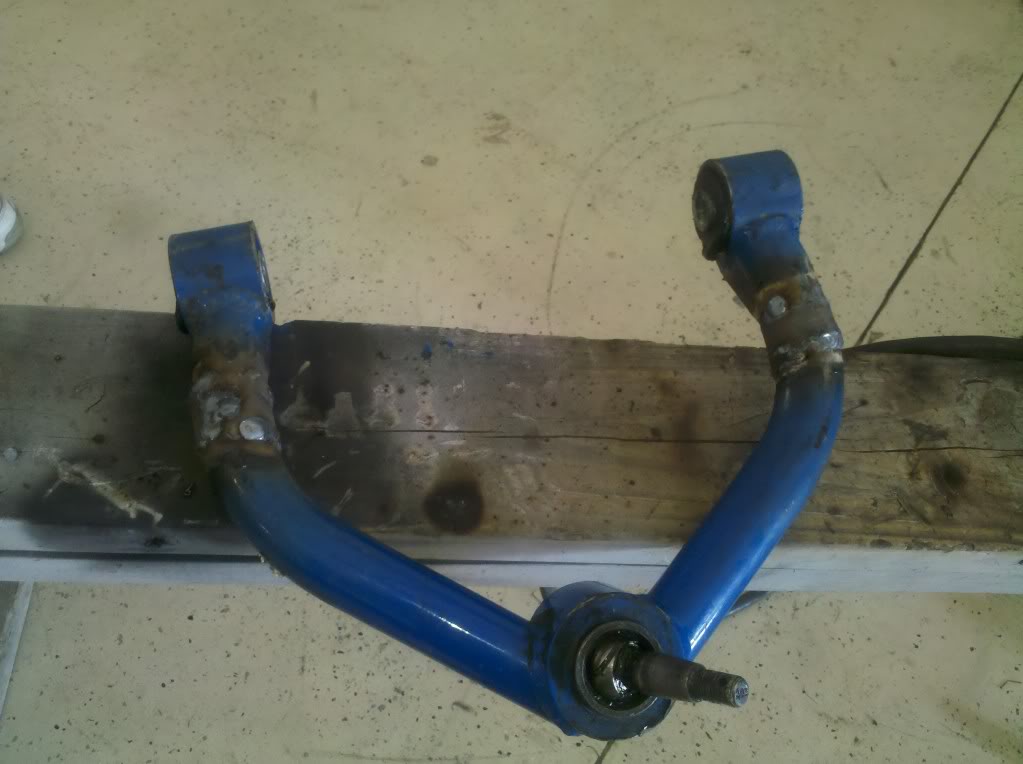

Go go gadget upper control arm! Passenger side control arm stretched an inch and she's gonna be sittin pretty! Gonna install that, and get going on driver side. Finally ccoming together.
Thanks sherif, I am loving the way she's lookin.

i wonder if you could sleeve the upper c-arm and make it adjust

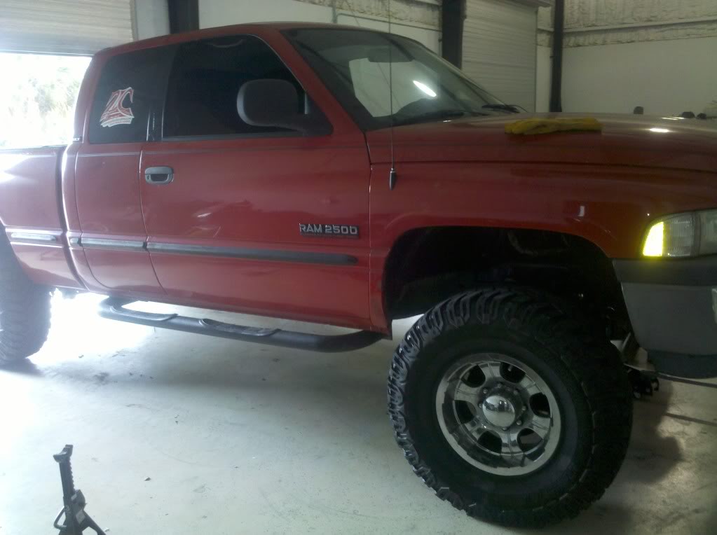

Dodge, I am sure you could on an s10, but not a 6500 lb truck. Plus I am going to put the shock tabs on upp c arm, so I need it super f-ing strong. Lol.
Here's a pic of pass side all assembled, and at ride height!. Lookin sick.

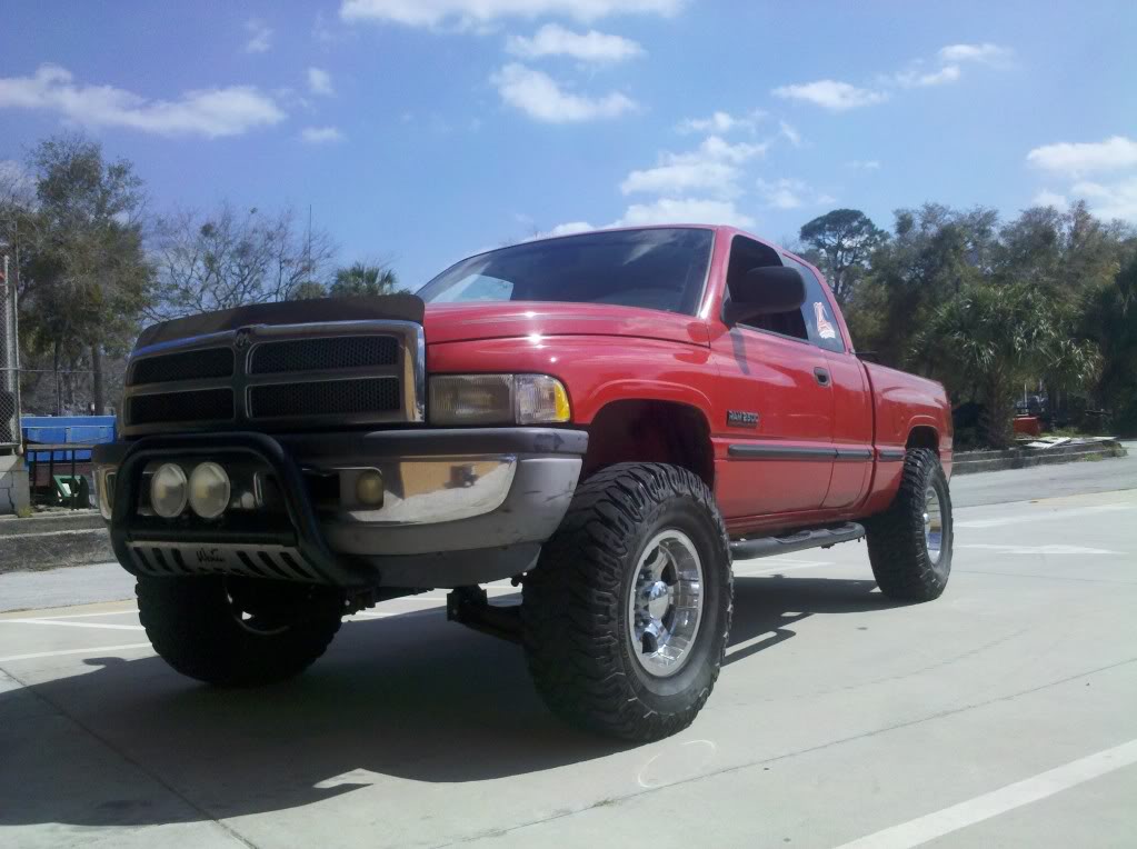

She's sittin high, runnin straight and smooth! Lovin life in that fl sunshine.
