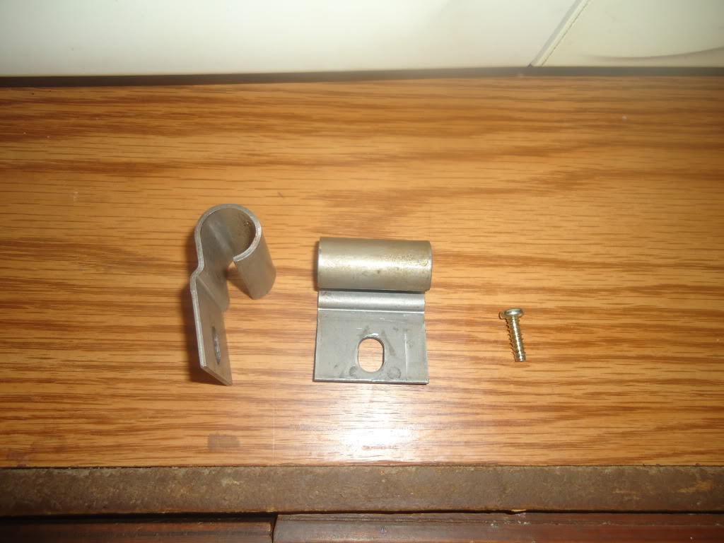

does anyone know where these brackets go. i think they fell down when i took the steering wheel bolts off and dropped the steering wheel. also this gold screw goes on the havc box but most of the screws are pointed and this ones flat at the tip and a little bigger around. the brackets that hold the heat core down use this screw but i have one left over and cant find where it goes.
