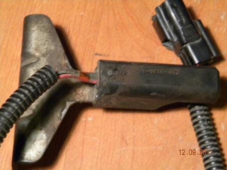

well visually it looks fine (i know that means nothing) but just thought i would mention it. can i test this with my multi meter? i only ask so i don't go dropping money on a part that may not fix the problem, it just seemd weird to me that it just (poof) quit working while sitting, not being drove or started and onviously not due to damage done by me on the transmission removal and install.

Ok, three wires.
Violet w/ white trace: 5 volt feed.
Gray w/ black trace: Signal to pcm.
Black w/ Light blue trace: Sensor ground.
Check resistance between feed, and signal wires, and ground. None of them should be zero.
You can try moving something metal past the pickup end of the sensor, and see if resistance changes as well.
Make sure you are getting 5 volts on the sensor feed wire from the PCM.
Make sure the sensor ground wire heading off to the PCM actually IS a ground. (there are like three splices in that wire.......)

ok i may need a little more in depth direction on all that, i can check voltage and check for continuity, i did set the meter to 20k on what i was told is resistance and touched all the tabs on the sensor and looked for readings, and it did nothin, just read out with the 1 as if i were haldong the probes apart from eachother
Old Dec 12, 2011 | 09:45 AM
Posts: 87,483
That's bad. Grab a new crank sensor.
