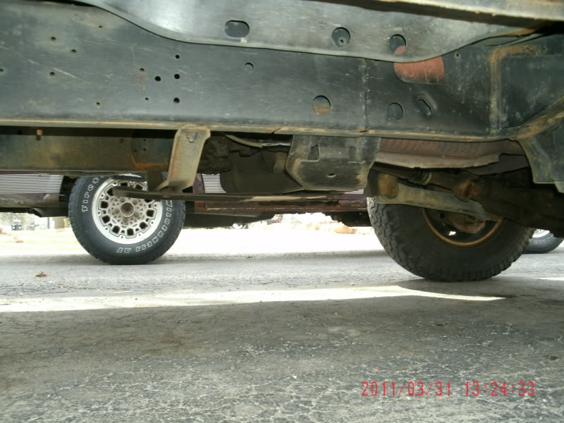

Hey you can you post a pic of said "bracket"?
Yeah, I can get one up tomorrow. Cold and dark out at the moment.
There ya go. The main crossmember DOES hang down a ways. Looks like with the one linked in the first post here, you could pick up an inch or so of clearance, just have to do something about the rear mount for the skidplate.

Hmmm. You could take some 2" x 3/16" flat stock and bend it in a shape similar to the back and weld to the new crossmember to bolt the stock transfer case skit to.

Shoulda got a better angle on the pic, but, it was dark under the truck, and the pic turned out better than I though......
But, it looks for all the world like everything is up above frame level, so, the new crossmember, and just a flat bar across the frame rails in back to mount the skid plate to, would probably be adequate to the task. The trans mount would be almighty short though.......
