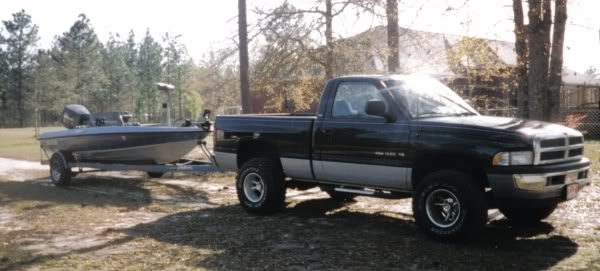

I put a body lift, a level and a couple small blocks on my '98 RCSB 5.9 4x4 when I had it, I'm guessing the over-all lift was about 4", maybe a hair over. I ran 35's and only had to trim a bit off the well liners up front for no rubbing at full turn.
Yeah, it looked badass IMO, but gas mileage did suck. I rarely hit 10 mpg in all-around driving and maybe, just maybe could nip 12 mpg on trips IF I kept it under 65 mph.
Luckily, I had a daily driver, the ex's Grand Cherokee and a company van to use at the time, so gas mileage wasn't even a thought...
