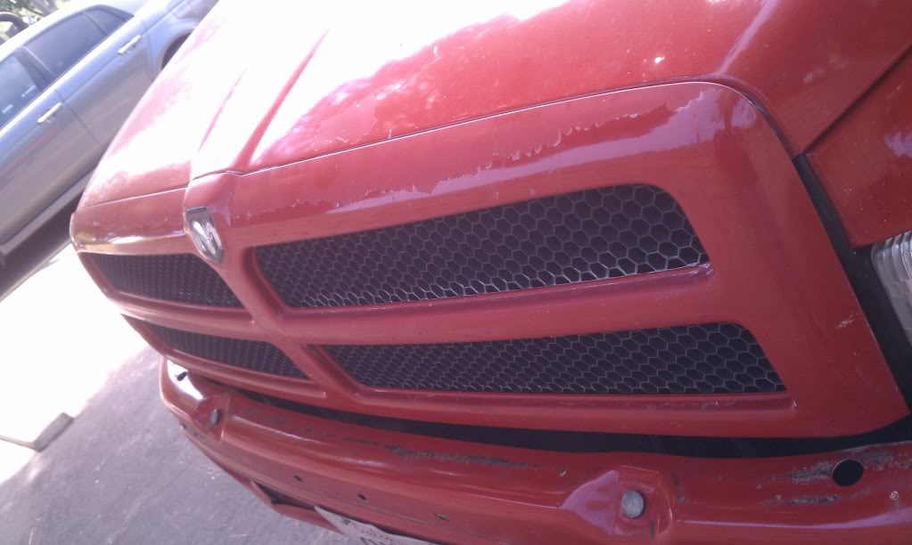

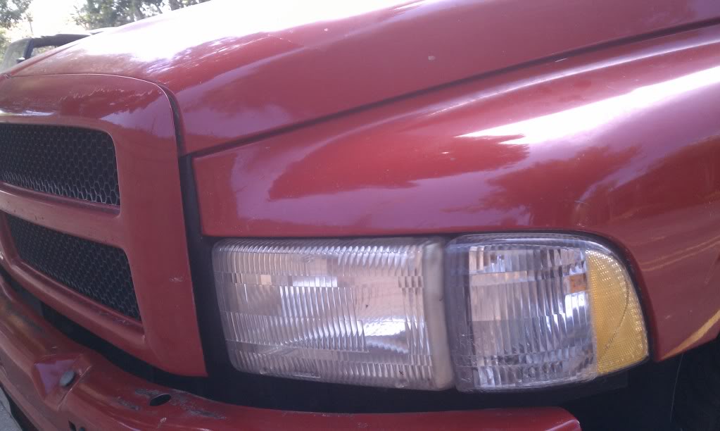

Ok so please don’t call me an idiot or tell me search the forum, I HAVE. I know that the "Sport" is entirely cosmetics and that is what I am working on. My headlights are super yellow, and my turn signal casings are spidering and cracking up. It’s definitely a TWO BULB setup and it looks like there is two pieces even. The turn signal light I don’t know how I would even get to when changing the bulb. My grill in the front also from opening and closing the hood is messed up. Everywhere the grill attaches to the metal framework the plastic holes where the screws fasten it are broken. Yeah I JB Welded it back about 5 times now and am finally getting fed up. Here’s pictures:

Sadly, you have a standard single headlight setup. The dual bulb setup appeared somewhere around 2000 ish, along with the special urethan bumper cover and elongated grill.
Your grill is a standard black plastic ram grill painted body color.
The turn signal is accessed by removing a screw at the bottom of the ts housing (which is partialy hidden by the bumper, and then the housing itself slides forward off the headlight housing assembly.
The headlights and grill you posted from ebay will fit your sport, but what you need to ask the seller is if the headlights have adjustment assemblies on them. many do not, and thus you end up with cool headlights that don't allow you to see anything at night.

They will bolt right in, and hook right up. It wasn't until 99 that the sport model had different headlights than the base truck. Even the front bumper is the same as the regular trucks, its just painted, instead of being chrome. (same for the rear.)
I am pretty sure its the same for the grille. Same thing as the regular trucks, just painted, instead of chrome.
