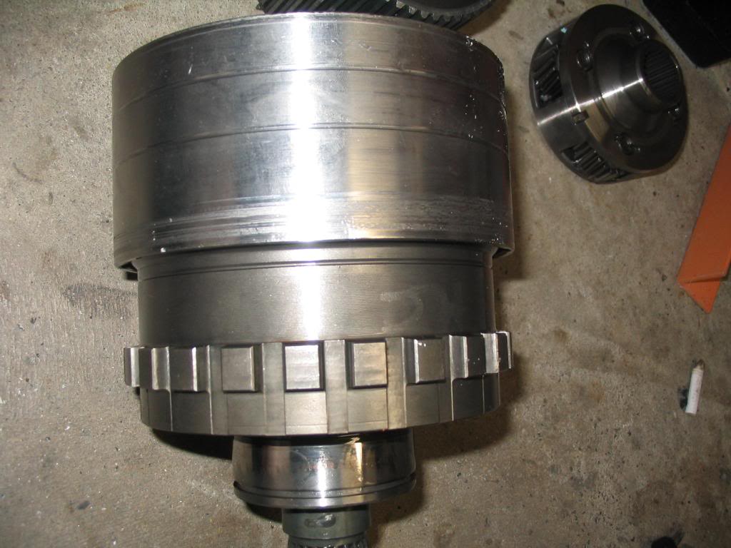

Can anyone tell me if this drum is in reusable condition? It's the only thing at this point keeping me from putting it back together. The scores and scratches on the outter surface are from the snap ring that broke and got pinned between that drum, and the extension housing. At least a week out from multiple sources...Thanks guys

Well another weird occurence. Whomever was in this transmission before me, put two seals back to back on the output shaft of the extension housing. I guess he didnt have the seal with the wider flange for that sealing surface. I'm hoping this isn't that way it's supposed to be. Lol...

Easier said than done my friend...thanks though. Roberts a very busy man I'm sure. I was just curious if anyone else had seen two output shaft seals installed before. Just another odd thing to try to wrap my brain around....now if I can just determine which one of the three seals in my overhaul kit is actually supposed to go there, ill be golden and can move on. I wonder if the second seal was acting like some kinda shim...very odd.

Can you take some pics of what your talking about?
