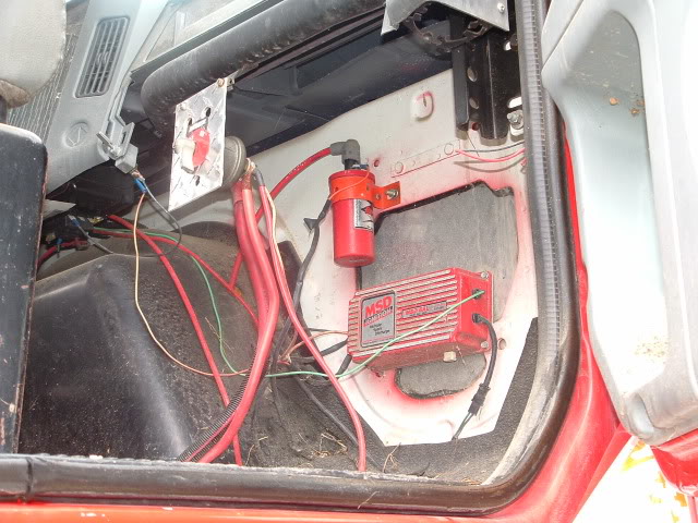

Ok I just want to show you guys something.
Some people say that msd boxes do nothing and some say they work. I went on vacation in July of this year On the way down we pasted Dennis Andersons house and on the way back we stoped. I was looking at one of his monster trucks and guess what I found in it on the pass side floor board. A msd 6al box.
