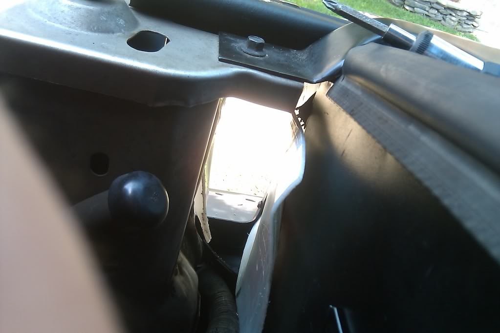

Already way ahead of you man. I used those insulated window things that lower indoor temps by 40+f, they are fireproof also. The tubing going to the air hat was scortching hot with it being right over the exhaust manifold and engine overall. After i put that insulation on i drove it around got it nice and hot, and then took the insulation off and felt the tubing. Its deff way cooler. Id say at least 30+f cooler, b4 it was hot, now it was just warm.
As far as improving HP i have no idea. I dont have a dyno i can just test it on everytime i change something. I also have no room really for a bigger air hat as the magnum's in the Jeep engine bay really leave no room between the hood. So i still need to change that. Gas mileage has actually gone down i think in the city. From around 13mpg to 12.5mpg. If gas mileage went down then that means I have more air coming in the engine and it is colder so my HP probably has increased by a good amount. Top end tho at 60-65mph my gas mileage increased by about 2mpg from 16-17mpg to 18-19mpg. This is a combined whole with the CAI and the insulation. I also add'd scoops from the grill so air blows directly to the filter as you can see in the 2nd picture.
I wish my gas mileage didnt go down tho in the city, im still wondering why it did after i add'd the spectre filter and removed the air box. But im pretty sure its because of all the mods i did which made the air going to the engine colder and free'er flowing, and more/colder air lowers gas mileage but increases power

You have a mechanical temp gauge installed there as well??

What do you mean ?

Think he's asking about the T in the rad hose

Yep, Aim hit the nail right on the head.
