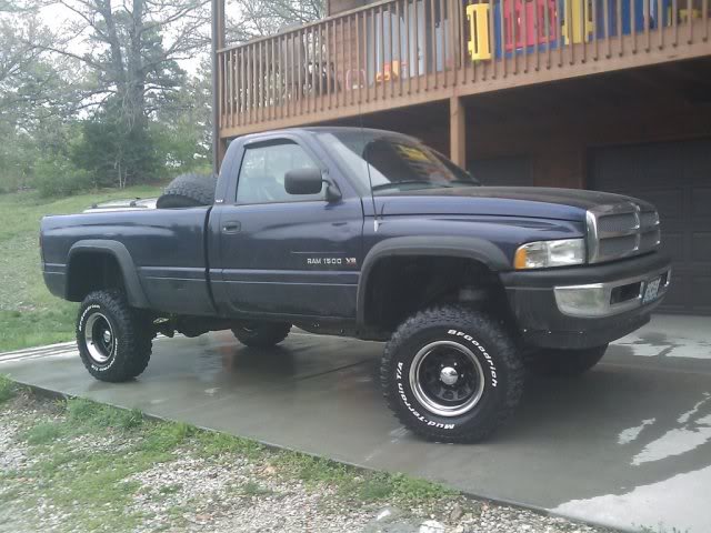

this is what I want my truck to look like 3 inch suspension and 3 inch body on 33s I might go with 35s. I have all of it I just need to put it on.

yea 5 inches of lift plus 35s should be tall enough im 6,3 and dont like having to go down to get into veehicles i want to go up lol

I think this was debated before... but, once you get over 3" of lift, (and you are already starting with 2.....) you need to address the front control arms as well. I don't know if the Off Road edition trucks came with longer control arms than the non-OR trucks.....
Once you get over that magic number 3, lifts start getting expensive.....
pitman arm, sway bar, brake lines (if u wanna do it right), shocks, etc ...also the cost of an alignment

anyone have pictures of one that would have 1 inch coil spacers up front and 3 inch body lift´
