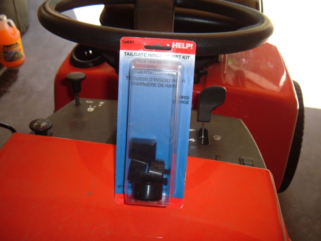

PB sucks!!!!!!!!! Get some Cyclo Breakaway. After you clean the back of the handle mechanism ,latches, the rods(and plastic clips),use some grease or CRC or Cyclo white lithium grease to lube them up.
You can also get new bushings for the pivots from the HELP section. (might have to order them depending on what part store you go to).
