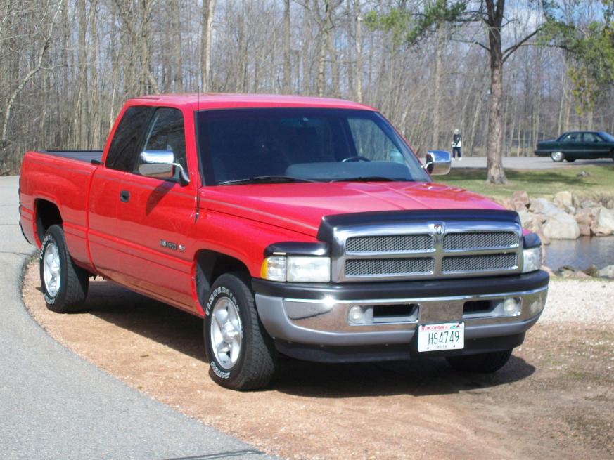

On my 97 1500 2WD, the sticker on the driver's door column calls out the tire size as 225/75R16, but the Dodge build sheet shows is was originally sold with 245/75R16s.
And to complicate things further, there are apparently three tire sizes that could go on the truck: 225s, 265s and 275s, all 75R16s. This is according to Tire Rack and Ebay's Tire Center.
So which one is correct, the door column, the build sheet or the tire seller?
Which size would you use?
Thanks!
