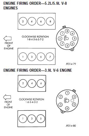

Did you go by this, and trace each wire from cap to the plug?

yes, i went by that and ive traced and re-traced 3-4 times now. im as we speak here trying to wire in the obd2 data plug so i can read codes. hey you was saying it could be arcing in the wires, they are less than a yr old and are just cheapy oreilly brand. i really dont have money to throw at this truck anymore but i could go get new cap rotor and wires again if it fixes the problem. my problem is if i spend the 60 bucks and it doesnt fix it then im out that money too.
unplug coil and it cranks as should, plugged in and it cranks 2-3 revolutions and then really dies down and voltage drops to about 8.5v...
