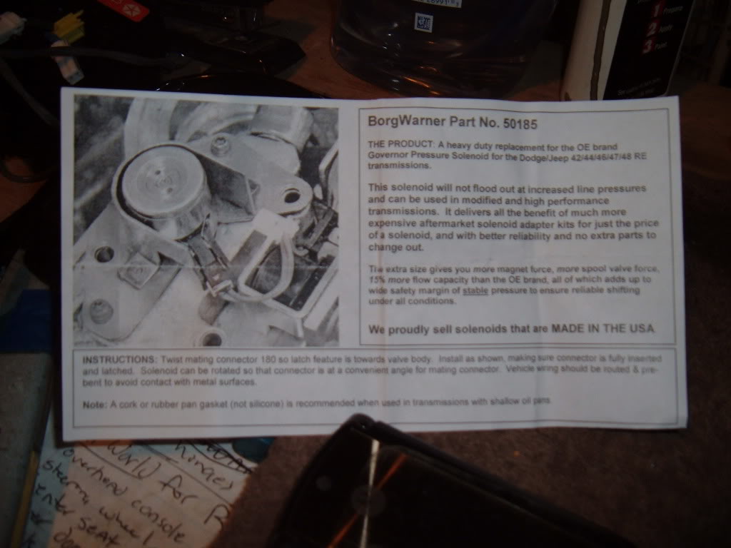

ok took me awhile to get the codes cuz me and my wife been moving so heres the 2 codes i got from autozone P1762 and P1764. if its the solenoids wheres the best place to get both for a good price and good part cuz i dont want it to fail month later
Old Oct 24, 2011 | 12:58 PM
Posts: 87,393
Likes: 4,213
You can get them from the dealer, or, see if you can find someplace that can get you the better design borg warner units. The solenoid looks to run less than 60 bucks, sensor should be cheaper.

Wit transmission online or a descent local shop.
