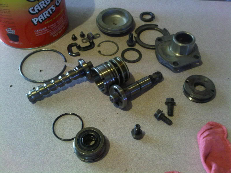

Got it all apart, cleaned and ready to go back together. Gotta wait until tomorrow to reassemble. Need aluminum shaft or tube with a 0.675" dia to be able ti reassemble ***** screw.
Tie rod ends and idler replaced.

If you're building this as a DIY, which is thoughtful if you do, please, please, PLEASE take pictures before each step as the parts are laid out in their installation sequence and then after they're installed. Also, my pet peeve is people who take pictures for the forums with a POS cell phone and qualify it with, "Sorry for the crappy cell phone pic". Is it THAT DIFFICULT to preview a picture before continuing to the next step? If you have a crappy cell phone, how about A) upgrading, or B) getting a decent digital camera (not too difficult these days).
This isn't a criticism of you -- just some suggestions and a side-track rant. The pics you have thus far are perfect.
This is really great that you're taking the plunge to tackle this rebuild, gdstock.

Yeah. POS cell phones are an issue. I have blurred several and either retaken or deleted them. No photo is better than crappy photo imho. Blackberry here, with high end canon, nikon, and hasselblad in cases. But don't want expensive gear sitting on tripods around work area, and wouldn't think of touching them with greasy hands.
I am taking a large number of photos, and IF successful, will put together a DIY. Trying to keep greasy fingers from ruining bberry though.
