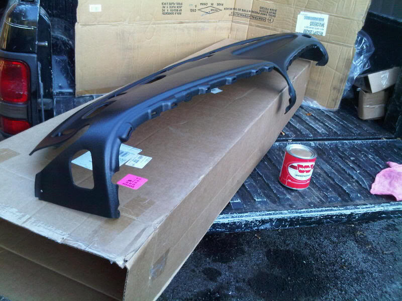

Not wanting to really hijack a thread - but don't think we need another thread right now about cracked das.
There is some healthy discussion of dash cap vs dash replacement. Although I already made my purchase decision, I would hope that everyone that has posted would keep updating what they decided and how it turned out. I received my replacement dash today from E & K Bumper Fillers Inc. Their website is http://sandkindustries.com/DASH.html.
It appears to be sturdy and well built, but it will require painting (unless your interior is black) as it is only available in black.
Will be late next week before I can start to install.

I got mine from E & K Bumper Fillers Inc. Their website is http://sandkindustries.com/DASH.html. I used double sided tape to hold vents to dash as they were from the factory. The two vents on the sides (side window defrost) utilize screws to hold them.
