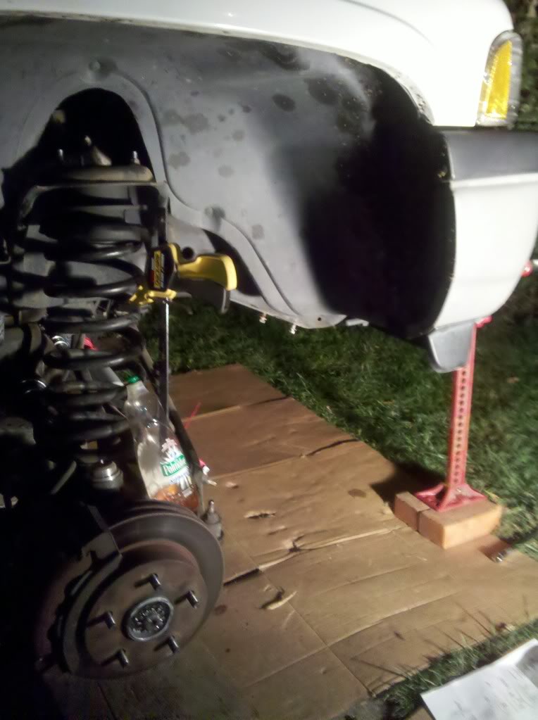

lulz, the 2.5" from HBS was not cake. I had to DC the sway bar. One jack stand on frame behind control arm, the floor jack on the axle, and my hi-lift on the front tow hook. This was in order to gain as much droop as possible.
Got the spring and spacer in....then used dish soap on the rubber isolator to get that phat boy back in. Perhaps I missed something...but that was not straight forward. lol

IIRC, my O/R springs are stiffer, combined with the bigger spacer is what made it tight. Here's my glory picture after getting the isolator slipped in.
