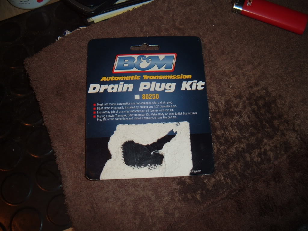

That's most likely the problem, very common. You should adjust the band while you are in there. Get a Haynes or download the free service manual from the FAQ/DIY section in the 2nd gen forum. Read the procedure. If you feel comfortable performing the procedure, then do that too. And let us know how the fluid looks and what you find in the pan. Also, another thing you should do is install a drain plug while the pan is off. I personally would get this one.
