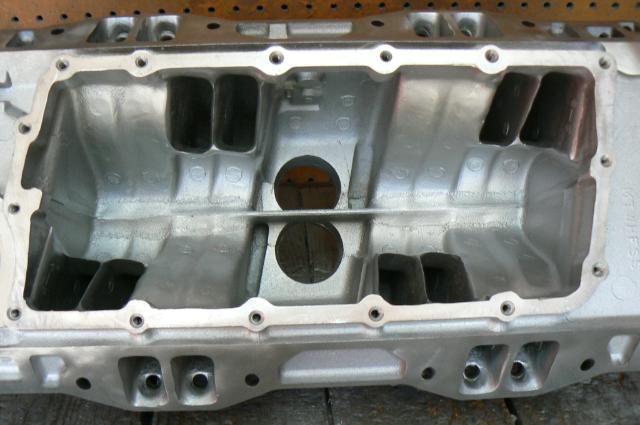

This is the last one I modified for a friend of mine. Cut the runners short as possible and tapered the runner intake ports to a sharp edge. Shortening the runners is only part of the kegger mod IMHO. Don't forget to gasket port the runners and smooth out the fuel injector ports.
What do you mean by gasket porting the runners? First Ive heard of this one.

Wish I had a closer pic of the runner ports but I don't so maybe you can get the idea of what I talking about in this one. If you'll notice the gasket marks on the intake where it matches up with the heads as to how much smaller the opening to the runner is as compared to the port on the head. Using the gasket marks as a guide, you open up the port on the intake to match the opening in the head. You can also see how screwed up and squared off the injector port are on the stock head.
You have to remember that a square edge inside an intake causes air turbulence and interferes with air flow. Eliminate all the square edges and you increase air flow.

Ok I have seen and heard of this, just not the term you used to describe. Thanks.

Yeah, usually referred to as "Gasket Matching", or, "Port matching". Really a good idea. Smoother flow means MORE flow, means MORE power.

Port matching was what I heard it called. I would agree with doing it. Only makes sense, It seems like it would be pointless to do the kegger without it.
