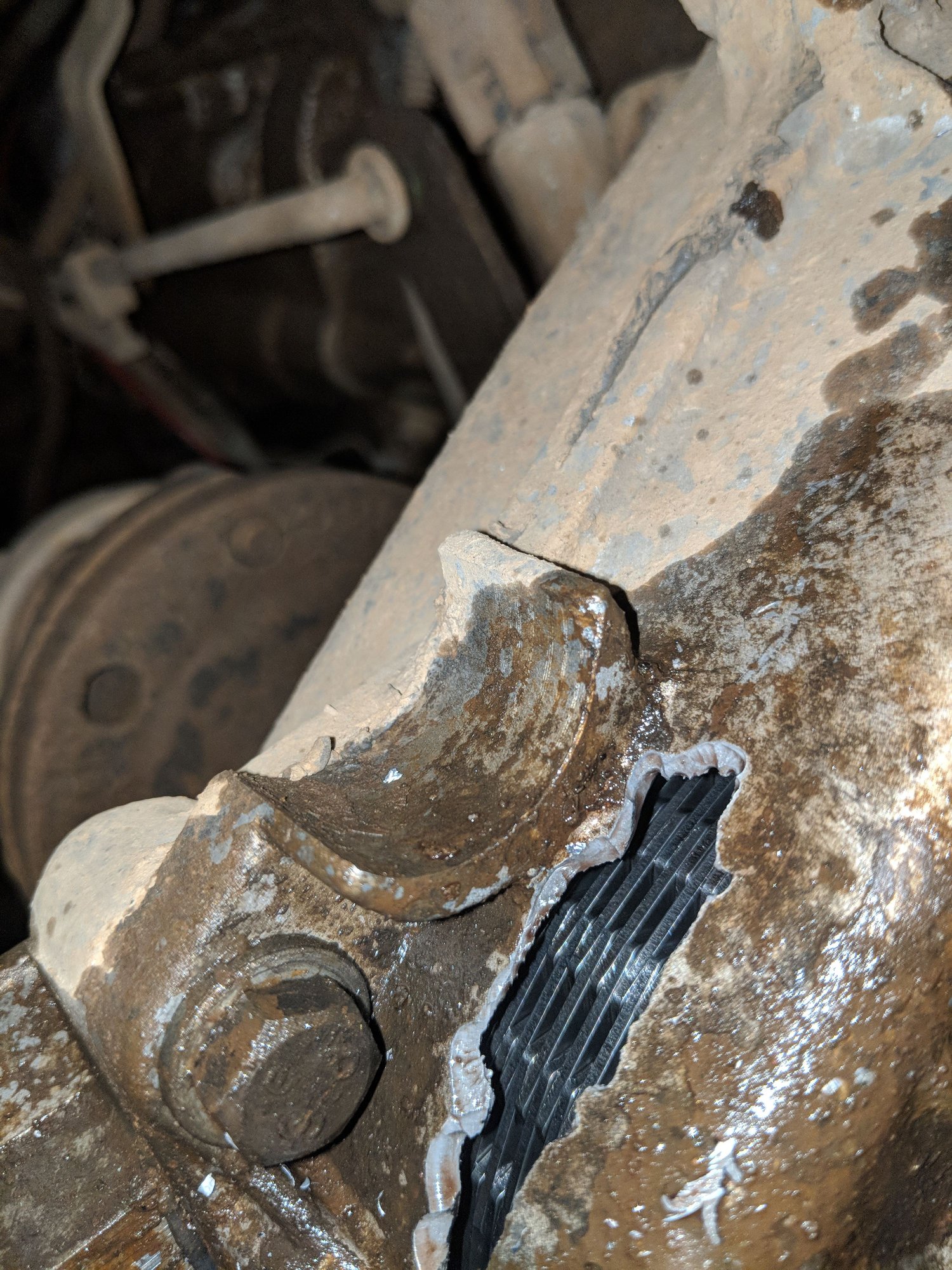

Old Jul 15, 2018 | 05:48 PM
Gregory Don's Avatar
Gregory Don
Joined: Jul 2018
Posts: 4
Default Interchangeable
Ok so I have a 1998 Dodge Ram 1500 lariat SLT and the transfer case literally exploded and I was curious I have a lead on a 96 and another 97 transfer case and I was wondering are they interchangeable if they come off like mine is a 5.9 magnum and they both come out of another 5.9 magnum so yeah are they interchangeable does anyone know
Old Jul 15, 2018 | 05:51 PM
Posts: 87,563
Likes: 4,232
You really need one from a 98 or newer truck. Shift pattern, and shifter mounting changed in 98......
