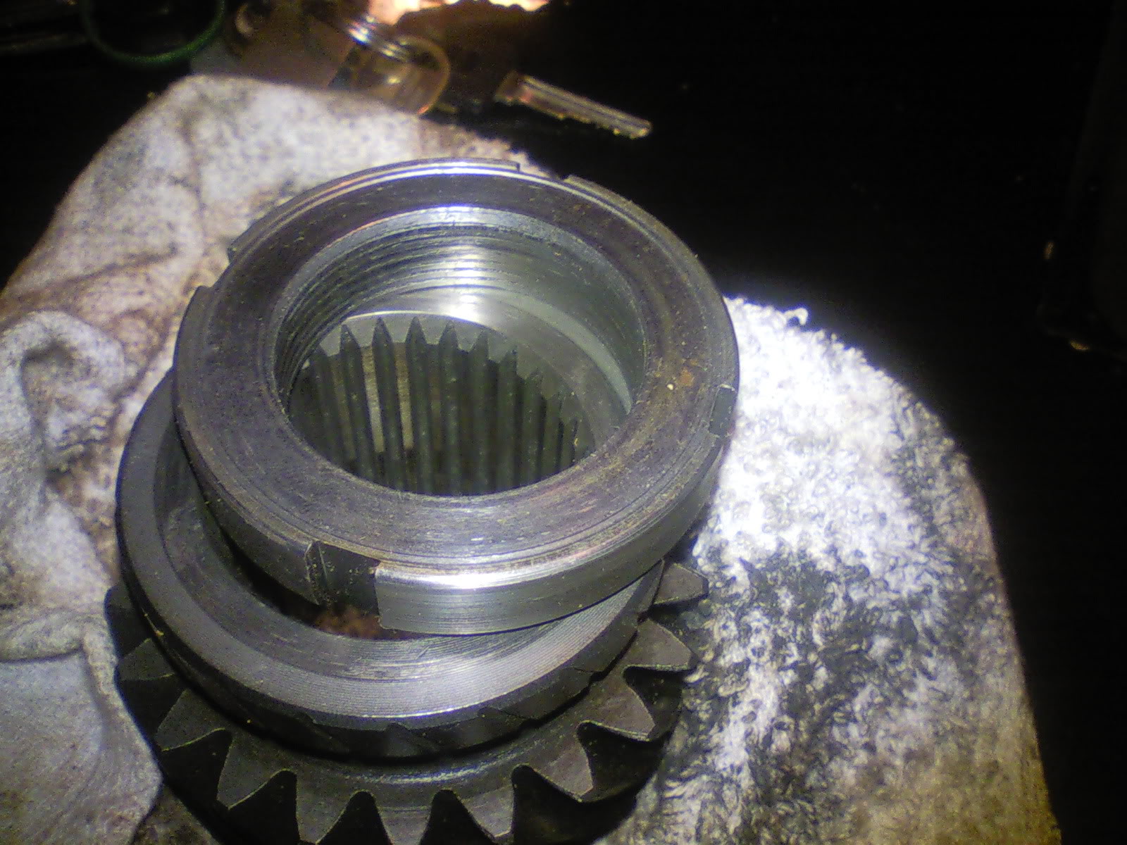

those threads are definitely stripped. but i wonder if mine was over torqued, cross threaded or something like that during assembly. i'm still in disbelief that a gas motor could have done this at all.
if stripping threads is really something that never happens than i feel better about welding to the gear. even if the cost isn't an issue, not having to replace the main shaft would save a TON of labor. and that alone is worth it.
i think i'll do that. just for the piece of mind. once i torque it down i'll put a small stitch weld on each side of it. to hold it there. something that won't break, but that i'll be able to grind off if removal ever becomes necessary.

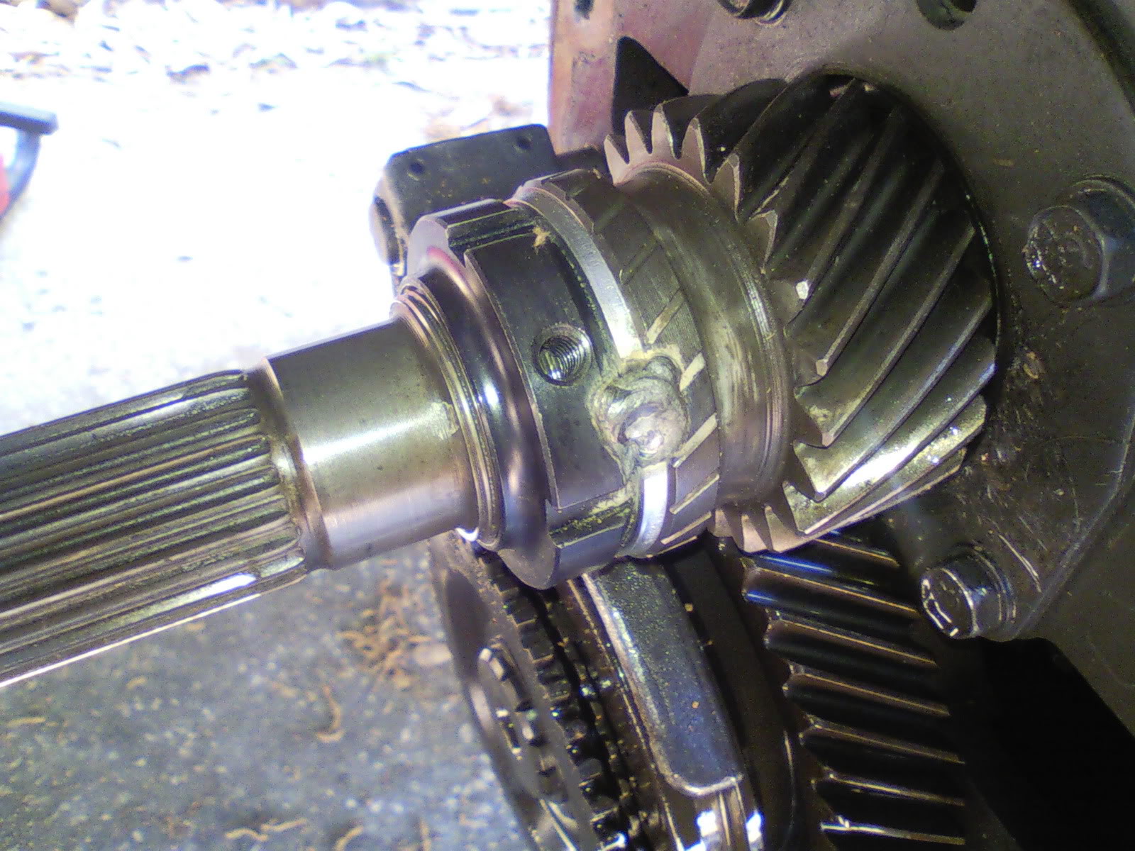

well there it is.
although if i'm honest, that thing was mother f*cker to get on. i don't know how these things back off it took all of my strength to get it on there using a 2 foot cheater bar. but it damn sure won't back off now.

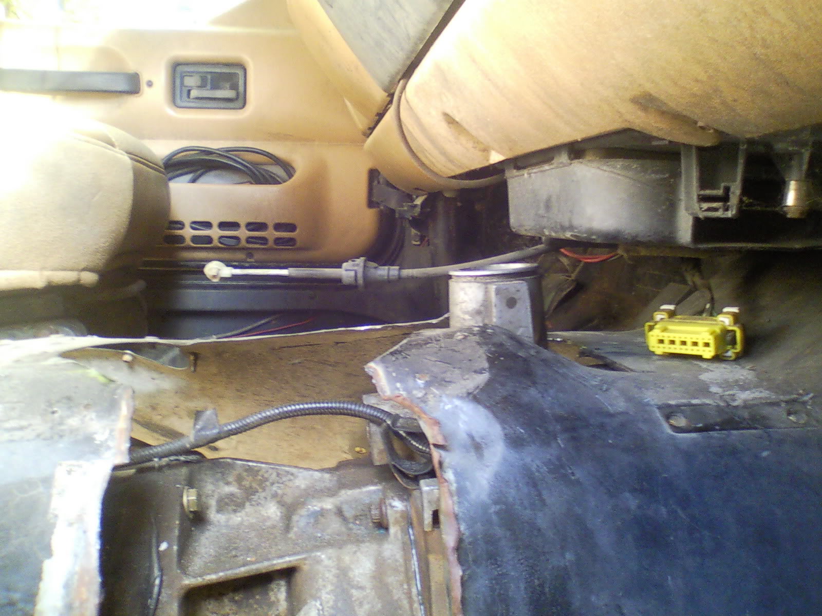

here is where the shifter hits the dash. i'm going to cut it and bend it back as low as possible. but i shouldn't have to cut the dash and with some slight modification, i'll be able to use the stock skid.

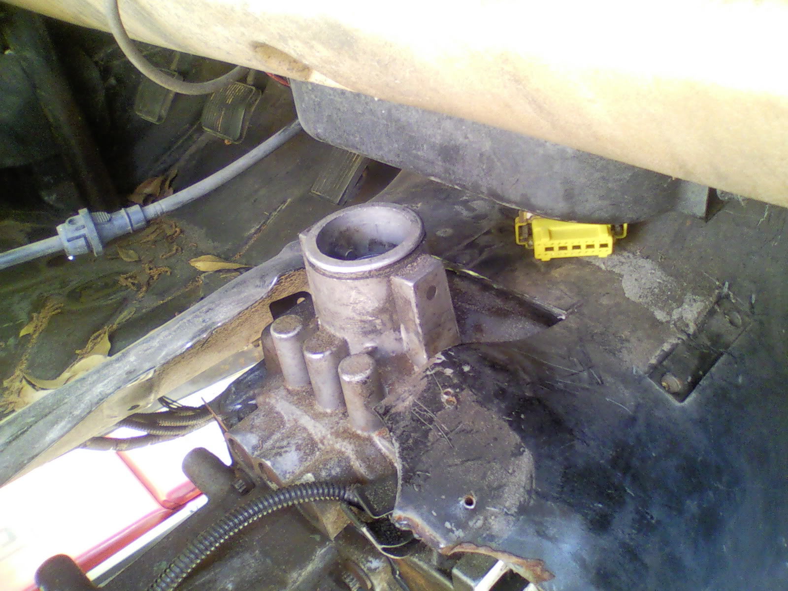

i also cut the tunnel a little further forward and got another inch up on the transmission. but any further up would require major tunnel re construction and i'm not that dedicated.

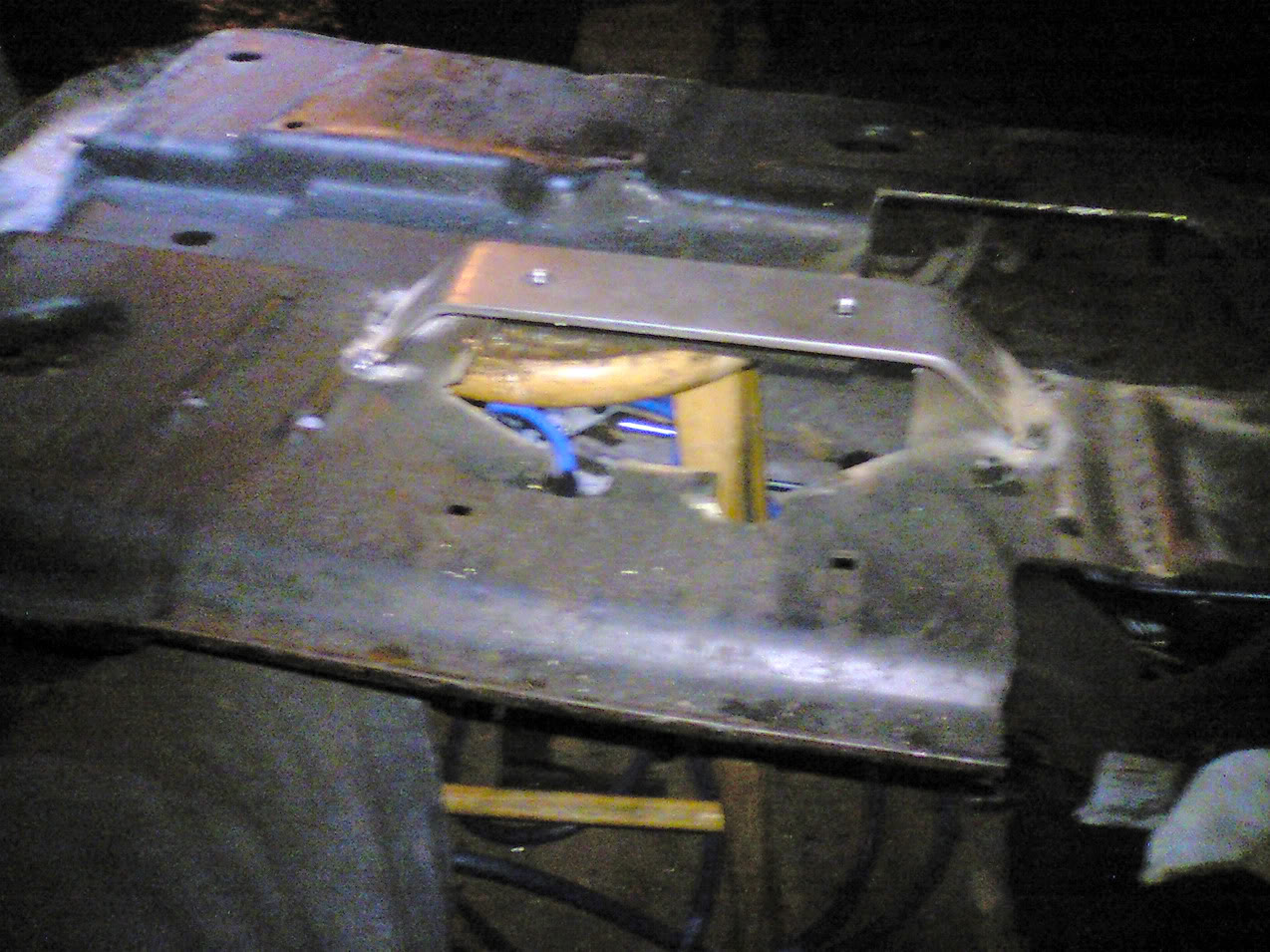

and finally here's the start of the modifications to the skid plate. i could have gotten away with using a transfer case drop kit, but i decided i'd rather contain the loss of ground clearance to the smallest area possible.
it's only tacked on now and after some test fitting i may reduce the depth of that bracket. i'd rather make it too big and cut it down than make it too small and waste the effort.
i only had one day to work this weekend, so not a lot got done. i'll have more to come as i get it done.
