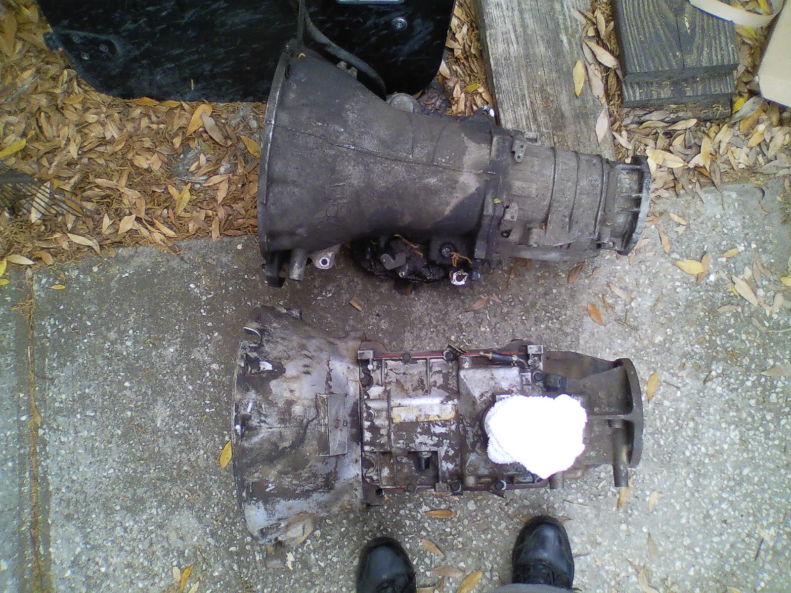

ok here's where i got over the weekend.
setting them next to each other, their lengths are almost exactly the same. anyone doing the straight auto to manual swap should be able to re use their old drive shafts as long as they don't change any thing else. the nv4500 is a tad shorter but the difference is so minimal that i'd have to get a level to find out exactly how much.

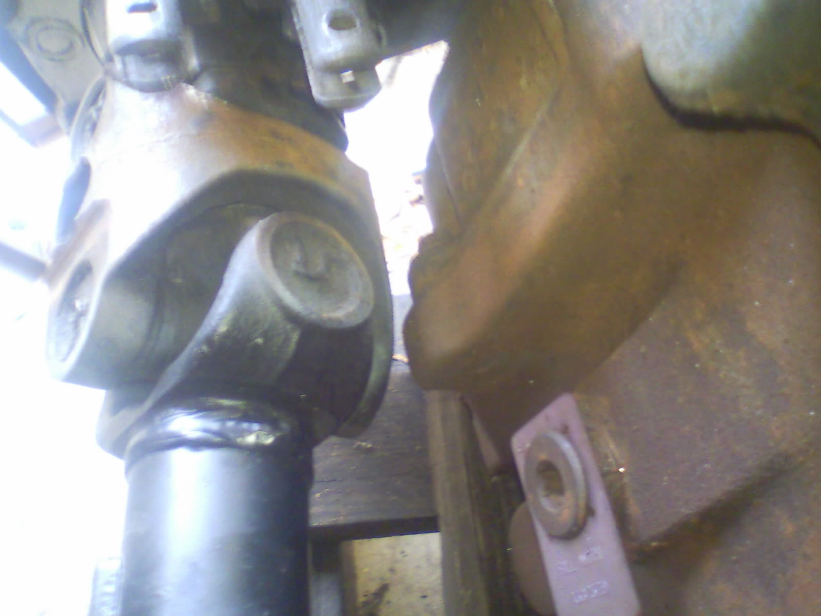

when using a dana 300 without a clocking ring on the back of a nv4500, the front output is really tight against the transmission when you are using a cv shaft. i may have to switch to a regular u joint here. i'll update this later.

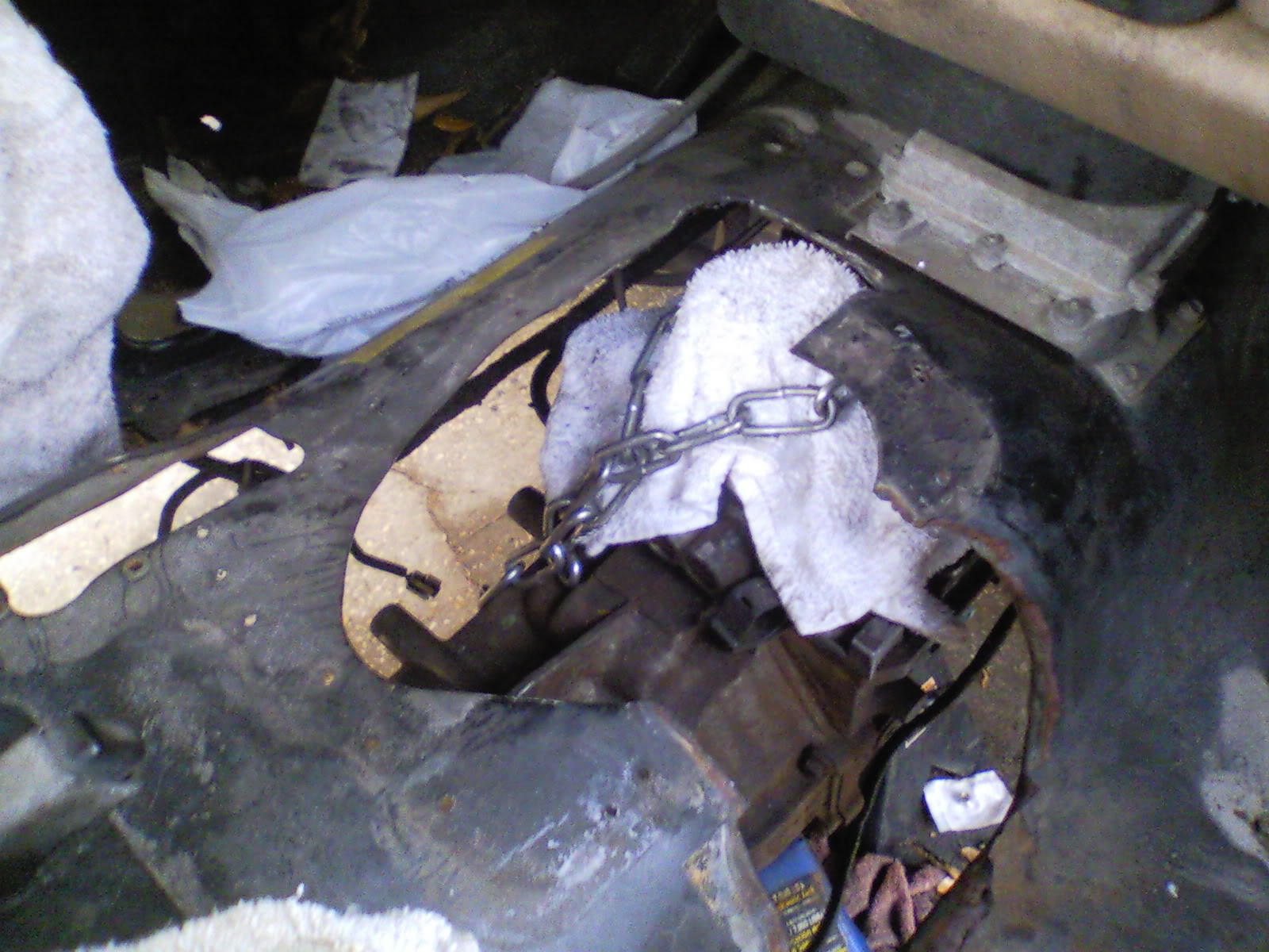

well futily i was trying to be lazy and hope that i wouldn't have to move the air bag module.
but i do. i have to cut at least another half inch out to clear the tower. and that means at least cutting the corner off the airbag module's bracket. maybe removing it all together.
also, at the current height in the above picture, this is how much of the trans is still hanging down.
so i'd like to get it up at least a few more inches. (giggity) and hopefully it will still be above my stock skid plate height so i can use that as the cross member as before without needing any major floor removal to clear the transmission. also i'm really trying to avoid having the shifter hit the lower part of the dash if possible. but ground clearance is more important than the dash if it comes down to only being able to choose one.
