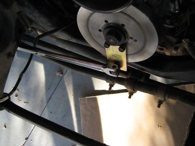

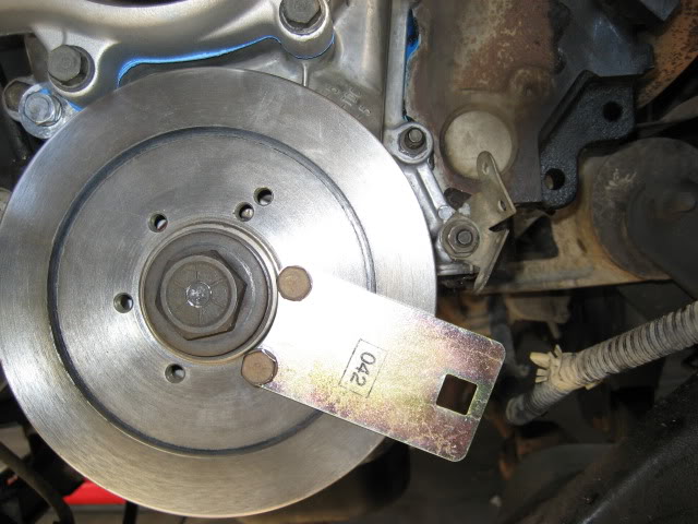

Another option to keep the crank from turning while you're working on the bolt is to use something like this. I used the pulley bolts to attach it to the balancer, then used a 1/2" breaker bar to keep the crank from turning.

Btw to keep the balencer from turning... go under the truck remove the starter on the transmission, take off the inspection plate. Get a pry bar or something and wedge it between the flexplate to keep the engine from turning. That will stop the balencer from spinning..
You are going to have to do this in order to put that big bolt back on properly. You have to torque it to i believe it was 90 or 95 ft lbs. It doesnt seem like a lot but thats what the specs are. The only way your going to torque it is by holding the flexplate still. So this will be a 2 person project or 1 if you can manage to wedge it good enough by yourself.
