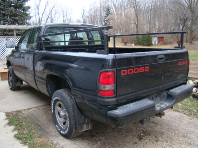

96 ram, extended cab, 4x4, 318 auto, 165k miles $1000!!!!! It does need some things looked at for that price though. It goes into reverse frimly, and OD some times flutters a bit, so I'll have to address that. It needs front shocks for sure. The plenum needs to be looked at for sure, and I really want the cruise to work. The cruise light lights up, but when I go to set it, nothing happens. I will be reading up on this for sure.

Check the vacuum line for the cruise, I think on yours it starts at the front of the throttle body, runs across the front of the engine, and then to the cruise module under the battery. It's one of the plastic lines, which tend to get brittle, and break as they age. Also, being RIGHT under the battery...... if the battery does something strange, the mess ends up on the cruise module and vacuum line, and the acid eats holes in either the line, the diaphragm, or both..... (I love my cruise control.....)

that was the problem when i got my 97. i bought the truck about 2 hours away from home and went to set the cruise, the light came on but wouldnt set. i was like damn.. checked the vacuum and the hard line had broken. replaced it with all new soft line from the intake to module. worked ever since.
