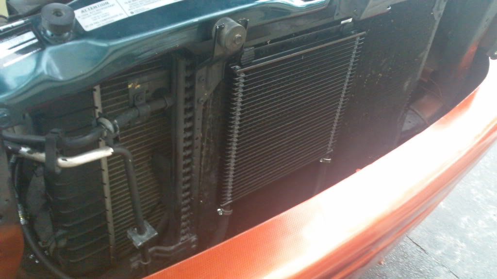

Old Jan 18, 2012 | 11:34 PM
  #25
dodgeman2289's Avatar
dodgeman2289
Joined: May 2010
Posts: 633
From: martin county/florida
got mine from advanced auto biggest one they had
