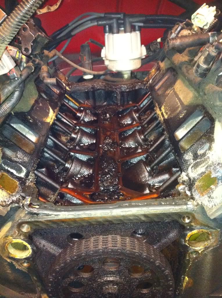

Yours looks clean compared to mine! I just broke up the carbon with a screwdriver and a shop vac to make sure nothing fell down in the motor. When I did the rockers the DS valve cover had a lot of build up too. Just scraped it out, put it back together, ran the truck for a few minutes, then changed the oil. You should be fine just watch the oil pressure make sure it's not too high or low after it back together. And you should have seen the plenum, it had 3/8ths inch thick carbon buildup all the way across.
https://picasaweb.google.com/lh/phot...eat=directlink
Wow what alot of junk!
I dropped the pan on mine and went ahead and spent a few hours cleaning the top and bottom side with diesel. Everything falls down to the floor when the pan is not there, then you just clean the bottom and your all set.
It still might blow up but I think the cleaning really helped, amazing how much junk can build up.

Hell that does not look that bad. I would just get the big stuff with a shop vac and call it good.
