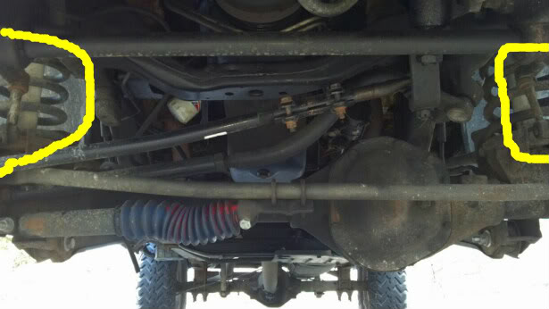

Also, went to look at previous picture. Your sway bar links are angled. Just an observation as can't see where the tires are pointed and appears you are on the ground, however, at an angle means the axle is not centered. If that is true, then you would be dog tracking like what Merc posted about with the rope around the vehicle to check for squareness.
