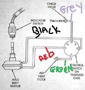

The grey line was probably at one time white... that's vacuum source for the CAD. The green line is just a vent line, and shouldn't be hooked to anything. Should be a little filter feller on the end of it.
The line on the drivers side of the keg is just a spare.... mine is plugged off to. (with a cute little vacuum line cap.)
Have you fixed your plenum yet? Failing O2 sensors, and clogged cats (which is what it does indeed sound like you have.....) are generally signs of a toasted plenum gasket. Do you go thru more oil than you think you should between changes?
great well i lost the plug. and yes that would make sense.. i realized that at work today that the green one, shouldnt go to the intake manifold too lololol. but idk were it hooks onto ill check it out later.
ok well my grandpa has been around for a little while and he thinks the plenum plate is not the issue. but the did say the cat. like the video it looks like its welded on, i can go try to see but. its 20 degrees out side and 1 in the morning. i can try to rip it off. and soak it or something im sure its bad.
the oil is fine, i over filled it when i changed it. and its still over full. but i think, i could be wrong but i think as i said in a different post that my coolant is... evaporating or some sort.
also with the green vac line off the transfer case right? well my freind unpluged it from the air intake manifold. and i noticed my rpms are at 900 rather than 750. is that good? exept im burning MORE gas. and im still getting 7.5 mpg with the 2nd o2 sensor.

Did you look at the link I provided? The green one goes to the TC switch just like the red,black and grey. And if the cat is clogged it's because of a blown plenum gasket and /or bad pcv valve. And you need to remove the TB and look all around inside with a flashlight and mirror, to know if the gasket is blown.
Why do I feel like I've typed the same thing in this thread 6 times? LOL
i got the picture, im just saying my grandpa dosent think its the plate. were thinking its the cat thats clogged pretty bad.
