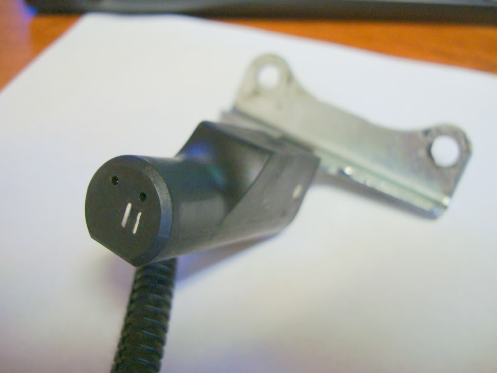

okay,today i decide to go ahead and take the crank sensor off to see what is going on with it,
pain to take it out,of course,
anyway,take it out look clean,and i said ,i will just put a new one in ,went to auto zone and buy one put up ,start the truck ,now my truck rpm goes up and down ,then up and down and then shuts down,hmmm,that not good...
i took positive and negative cables out from the battery and wait 5min + and also touched the two +/- so to reset computer,and after that put everything back and still doing the same thing!,
no check engine light but by turning the key 5 times,the check engine light told me code 12 and 55,
12 is for battery that was disconnected and 55 end of testing.
so i went back to the autozone and i told the guy that my old sensor did not do that!!,so he order other one ,maybe there is something wrong with the new sensor!,
now,the 2 sensors the look the some ,but the old one had some a little difference to it,look:
old:
new:
autozone purchased:
http://www.autozone.com/autozone/par...90514_0_0_1277
is there any difference to it? because i see that the old one has some 2 metal line in to it,and the new one does not!?
is there any other trick maybe that when changing a crank sensor that i may have to do?
or do i need to adjust the new crank sensor in any way? or just bolt it down?
also a small video how the engine is doing:
http://youtu.be/LgLiXM5oxgs
i have pressed on the gas few times ,but at the beginning of the video in till it stooped ,that what is doing...
any advice will appreciate!

These trucks really don't like aftermarket parts in critical locations.... Crank sensor being right there at the top of the list. I am not sure that the old part is factory either..... Granted, the dealership parts are expensive...... but, they actually work. Which is more than can be said for most of the aftermarket fellers.....
You need to verify your plenum. If that is leaking, nothing else is going to do much.

i have contacted the dealer and the guy said that his crank sensor
has the 2 lines at the tip also,so i guess that maybe a difference from my old one to the new one from autozone.
i went back to autozone ,and they order other one,maybe theirs is defective or something....
and maybe that's why my engine is doing all this rough running,they dont like aftermarket or that new one is bad,
also i dont know if this has a problem with whatever is happening but i was low little on gas ,and i put 10gal ,but all the idling ,i dont think is from the gas being low.
