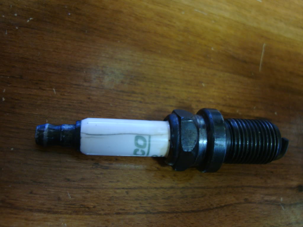

got some good news!
i found out what the problem was with my engine ,that was cutting ,
i decide to do the dry/wet cylinder pressure test ,so after i did it all 8 of them,
put new sparg plugs,but before i start the engine i inspected the old sparg plugs and found on cylinder nr#4 it was a crack on the white from top to bottom
now the truck does not cut anymore and also runs really good,tested on the freeway ,no shacking like before anymore...
really happy with the out come.
thanks to all for your info .
