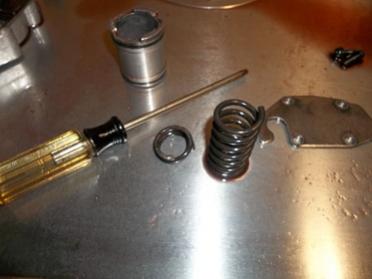

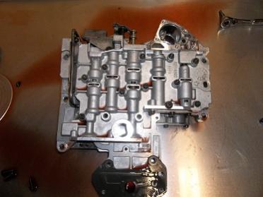

I am trying to find a good exploded view of the Valve Body on a 01 Ram 4x4. I pulled the valve body due to the trans only having 1st and reverse. I have found the spring for the 3-4 acumulator broken but it also messed up the piston (which I cant find) and the dealer has not been much help neither has any of the local trans shops.

Check Wittrans.com for parts. They should be able to get you what you need.
We also have parts manuals available for download in the faq section. Might have a nice view in the right one for your year truck.

Those springs are prone to breaking.
You may have more issues than that, but that is certainly an issue. In the FSM that HeyYou mentioned, there is a very good detail to troublshooting these trannys.

Ended up getting the piston and spring from cascade transmissions they were awsome and even gave me some pointers at other things to check got it back togather last night and drove it working perfectly.
