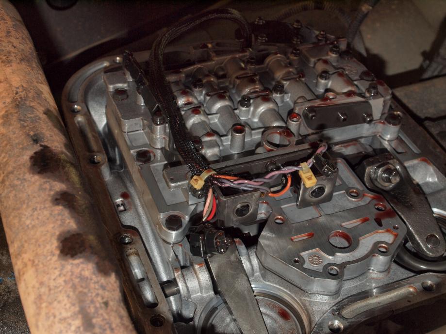

I bought the "overdrive and lockup dual solenoid assembly" because it was included in the kit http://www.ebay.com/itm/170789930133 along with the governor components. I dont want to drop the valve body if I can avoid it for risk of damage. Maybe I shouldn't replace the "overdrive and lockup dual solenoid assembly" unless the governor parts dont work? Does it matter that the loss of 1st and 2nd was an intermittent failure. At first they worked all the time with problems only occuring with and without OD. The more I drove it showing friends what it was doing the worse it got. I have included a picture of my tranny with the 2 governor parts removed to make sure were talking about the same transmission. Three star screws and a connector are visible to me. I was hoping those were the only 3 screws I needed to remove to replace the TCC\Overdrive part. Please let me know if you still think the valve body needs to be removed for replacement?
or
http://i463.photobucket.com/albums/q.../DE180038a.jpg
Thank you in advance
