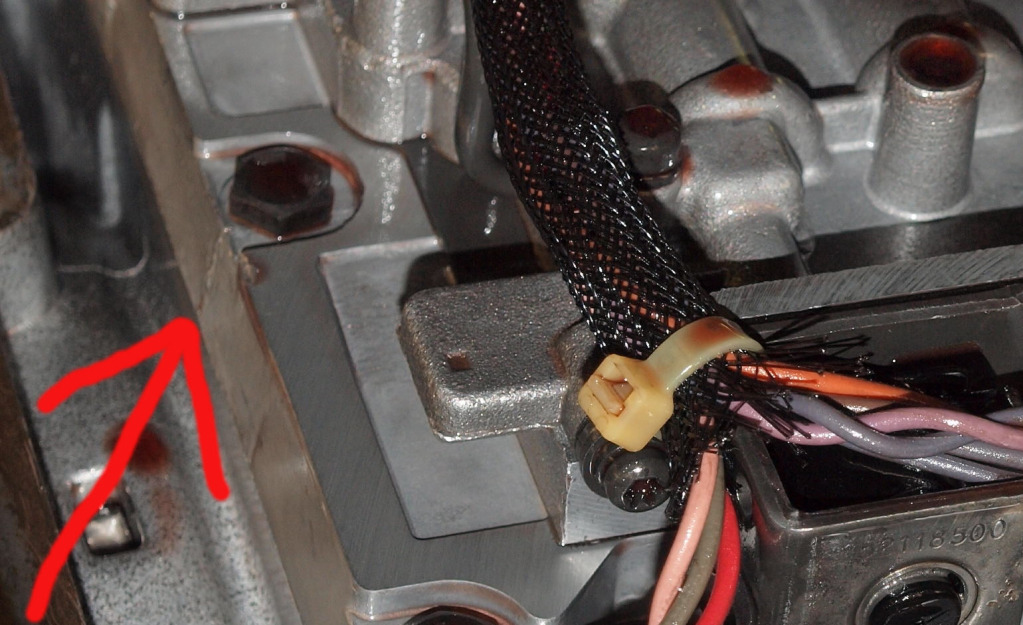

Also when I last dropped the pan I noticed a crack in the valve body which appears to only be alonside the screw. I am hoping that this crack doesnt extend into the VB any further than the edge where the arrow points to.
Last edited by pure adrenaline; Mar 23, 2012 at 12:03 PM. Reason: added picture and reason
Maybe the VB has been over-torqued at some point? That would certainly add to your shifting woes...... If you go in there again, it probably wouldn't hurt to just break 'em all loose, and then re-torque the bolts.

As long as the only crack in the valvebody is where you see it in the picture,you should be ok. The problems arise when it cracks between pasages or on either front or rear of the body where the passages to the trans body are located. I would suggest removing the valvebody and doing an air test on the body to identify where the leaks are. The clutch ports will create a light thump( clutch piston engageing ) and there should be no air leaks heard. The passages for the servos should activate the servos with no air leaks heard. The servos apply band pressure.
