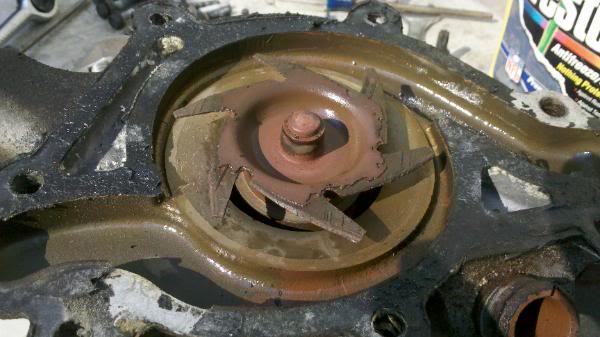

WP maybe?

Originally Posted by zman17
WP maybe?
THats next on the list. Chem tester was perfect. the guys at the local autozone know me pretty well so they just threw one at me.
Bought a new radiator cap just in case. Its been idling for a few minutes and temps are still holding kinda hot. Never used to do that even at idle and there is small bits of something coming out of the coolant. Im going to flush the crap out of it then change the pump next i think. Its a pretty quick fix when you do not have a mechanical fan =p

Take pics.
