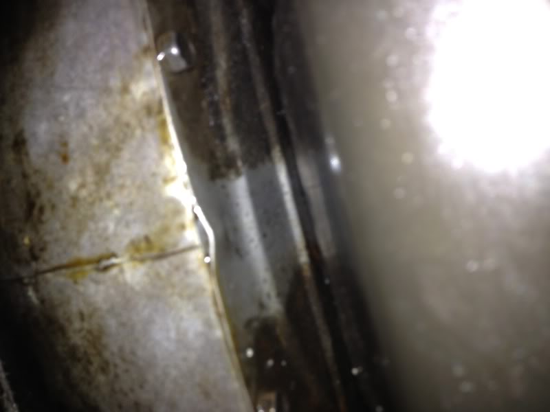

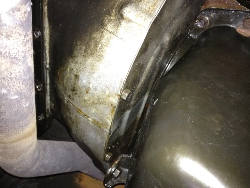

So I did the job again. Same result.
The seal was in correctly... facing the right direction and not damaged.
The crank had a groove but not too bad.
The new seal went in easy and I used the "shoehorn" to make sure it did not get cut.
The only thing I did not do is use Loctite 515 on the rear cap. I used a little Grey RTV.
The oil is coming down the front of the dust shield. Not oil on the pan... could it be something else?
When your rear main was leaking is this what it looked like?
Pic from top. Top of bell housing is "sweating" but not wet.

Old Jun 11, 2012 | 09:43 PM
Posts: 87,548
Likes: 4,230
Are you sure it isn't the pan gasket leaking?
Old Jun 11, 2012 | 09:49 PM
dhvaughan's Avatar
dhvaughan
Joined: Jul 2006
Posts: 12,204
Likes: 10
From: Gainesville, Ga.
the Service Manual and the Haynes manual are both the same, calling for a couple of drops of anaerobic sealant on the face of the flange.
http://www.permatex.com/products/Aut...ket_makers.htm
I don't see why a very very very thin coat of rtv on the flange face wouldn't work, but i just did as it said.
Did you put anything on the machined flange surfaces?
