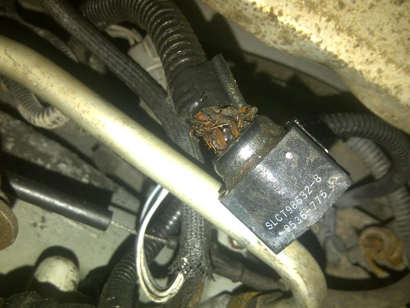

Download the 2001 fsm from the FAQ/DIY section so you can trace the wires. And check the 8 pin main plug on the tranny again.

Looks like the Red wire is the power feed for ALL the trans stuff. Should be 12 volts going in. Governor pressure input to PCM is in connector 2, cavity 29, Light Green/White wire. Check voltage at that wire, see what ya get. It's possible that wire is shorted somewhere along the way, giving false readings to the PCM.

Thanks for the tips guys. I looked at the 8 pin plug, it was definately better than that pic zman posted!! I havent pinned out any wires yet, but that is the next step. It sounds like the GPS input could be shorting to 12 volt causing this whole issue. If we can ever get this thing fixed, we will do a write up on exactly what we did. Thank you all for helping!!
