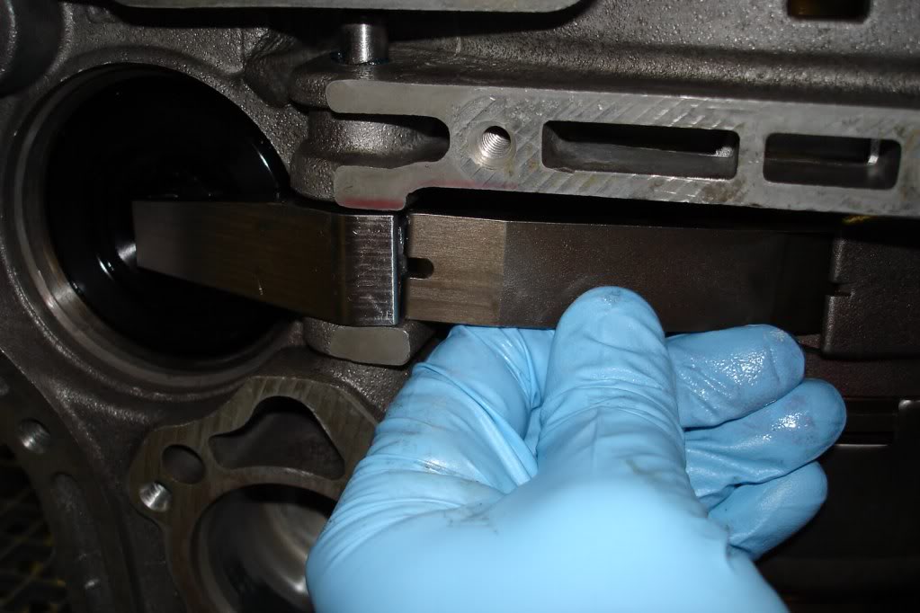

so im back today i pulled the valve assembly off and was wanting to know how to get the srtut back in. assumed the strut need to rest in the notch on the arm and then into the band. pics to come shortly found this excellant right up and picture my strut is a little more than an 1" in length and exactly an 1" in width does it just slide up behind the pivot arm in the notch at the top and into the band its a pretty tight fit how do a gain a little more room to get it in. much appreciated hopefully this will work.

Maybe this will help. http://dodgeram.info/tsb/1997/21-11-97.htm
One of these might help also. https://dodgeforum.com/forum/2nd-gen...e-manuals.html

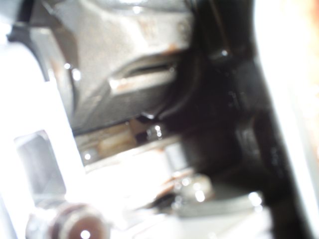

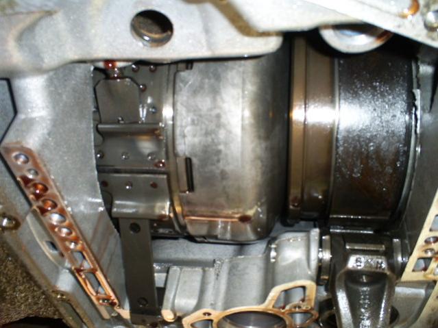

snapped a few pics earlier heres the trans
Attached Thumbnails 95 ram rear band adjustment-s5031663.jpg   95 ram rear band adjustment-s5031657.jpg

ok got the strut back in seems like it will work but what is the secret to getting the overdrive unit back in.. man i cant win with this thing.. seems i need the special spline tool to get this back in any way of lineing this up another way. i see in the manual the part number for the tool but haven't been able to actually locate one.
