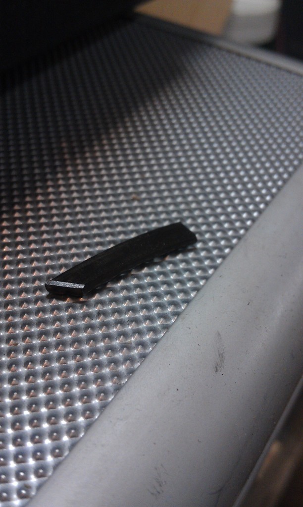

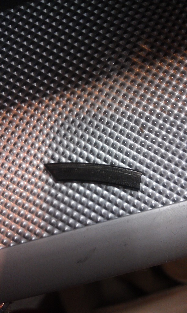

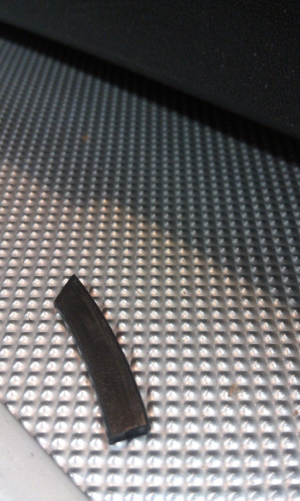

Well i went to go meet the tow truck and i started the truck up and put it in reverse and it went. then Drive and it went forward till i got to the road then i stopped to wait for traffic to clear, and when igot on the gas again... NOTHING! lol
here are some pics from what i found in the pan..
This was the only piece in there:

That is a snap ring form a clutch pack. Or part of a snap ring. With that out, the piston pushes without anything to hold the clutches agains, and fails to engage.
Rebuild or replace time. Sorry.

Part of the snap ring that holds the O/D unit together. Common failure. Transmission fails not too long after.....
