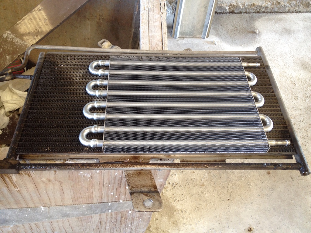

replaced tranny cooler today with the biggest Hayden unit i could find locally. Good for 10k+ lbs., recommended for RVs and 5th wheel rigs. Swap was fairly simple. Here are some pics.
Im guessing this is a stock cooler. it is way bigger than anything else i could find. I hope that size isnt a big deal with a tranny cooler cause the replacment is much smaller.

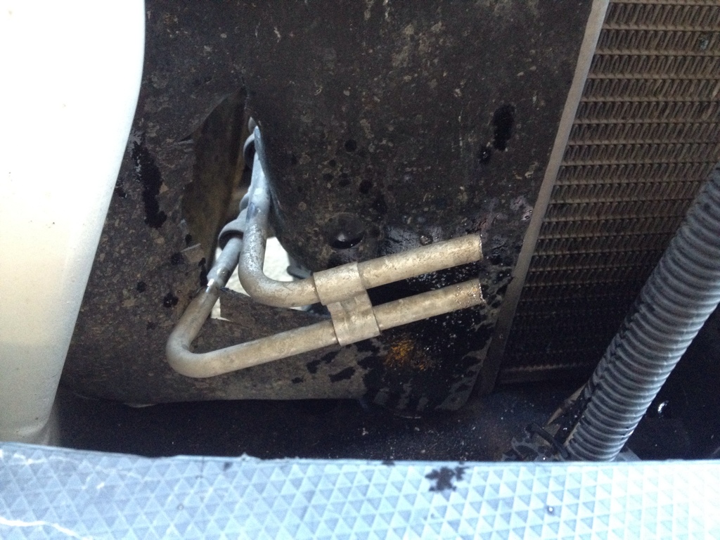

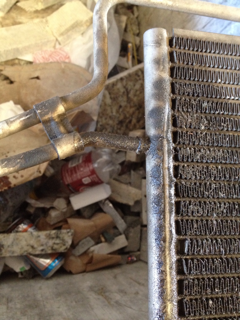

Thats where my leak was coming from. The solder had started coming loose. I am thinking about having it repaired at the radiator shop and reinstalling it or just keeping it just in case.

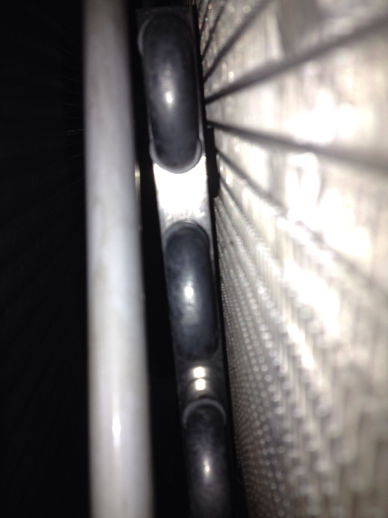

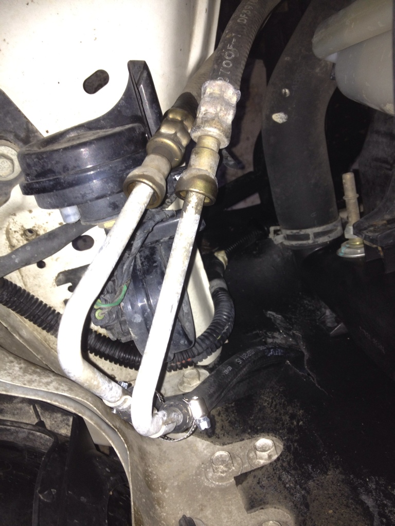

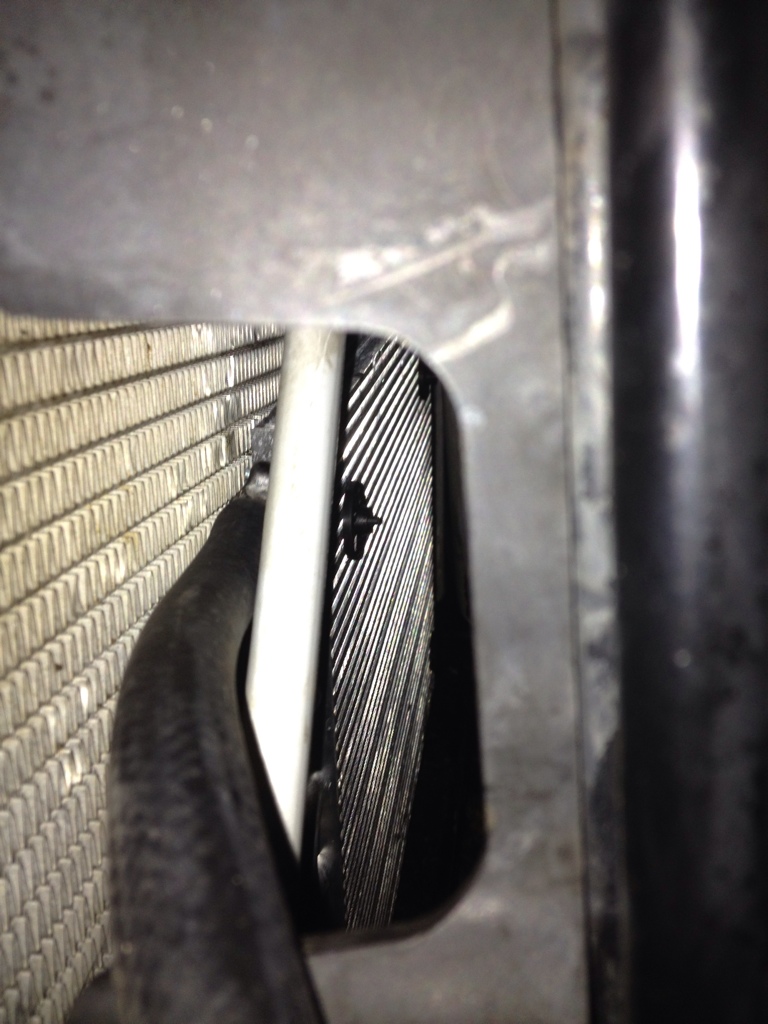

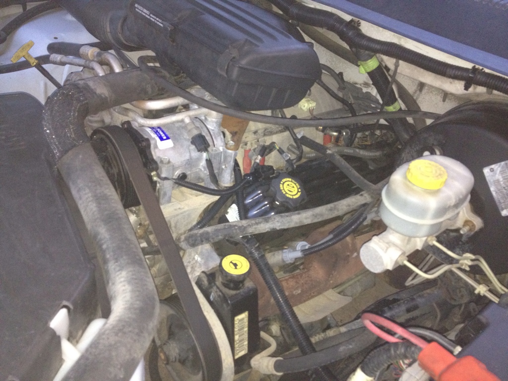

I installed the new one back in the stock location.

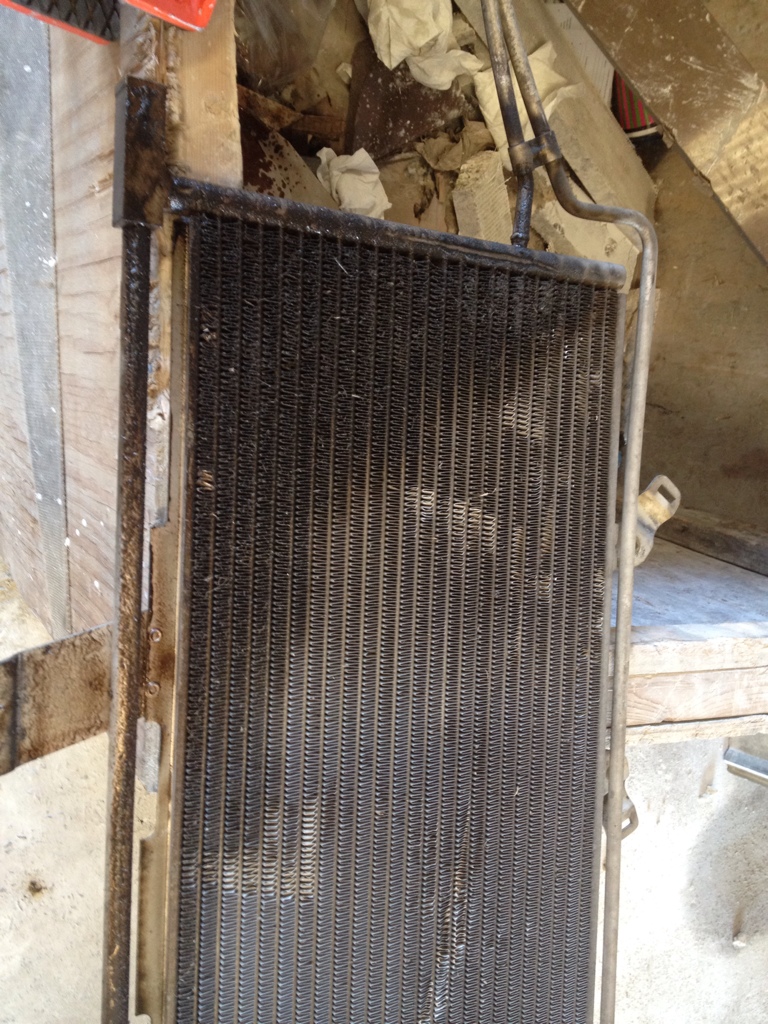

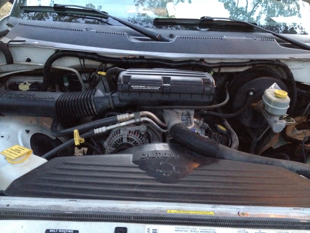

I also degreased the engine bay since it had got a thick coat of tranny fluid over all of it.

Old Jun 6, 2012 | 11:49 PM
gdstock's Avatar
gdstock
Joined: Jul 2011
Posts: 8,259
From: Austin, TX
That Hayden ought to work. I put the same thing on my RV and one that is the next size smaller on my Ram.
