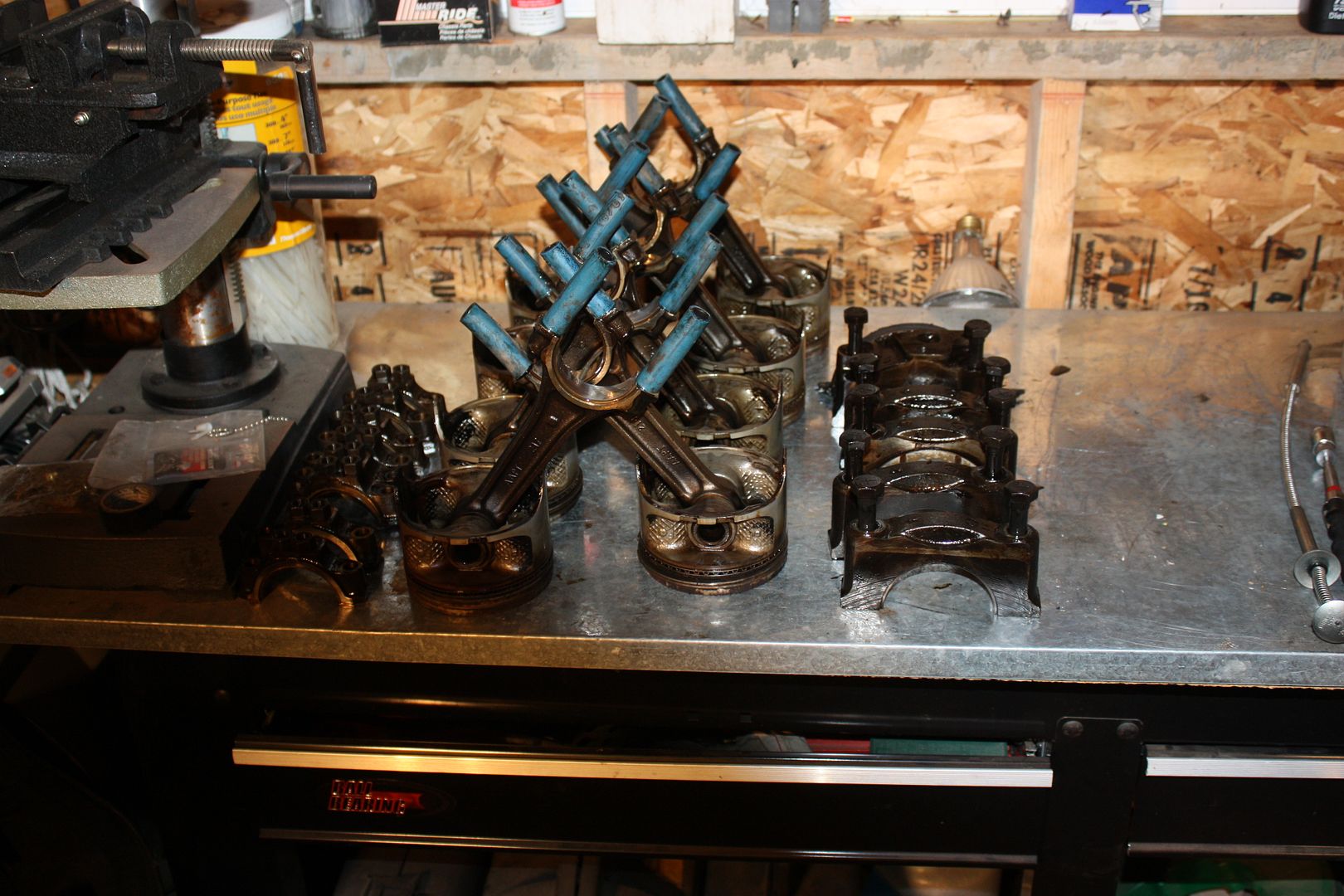

Well I got bored tonight and went out to the garage and played for a while. I have the block tore down now to the point where I will hook up the engine hoist tomorrow and take it off the stand. Then I can pull the crank and tak the flex plate off.

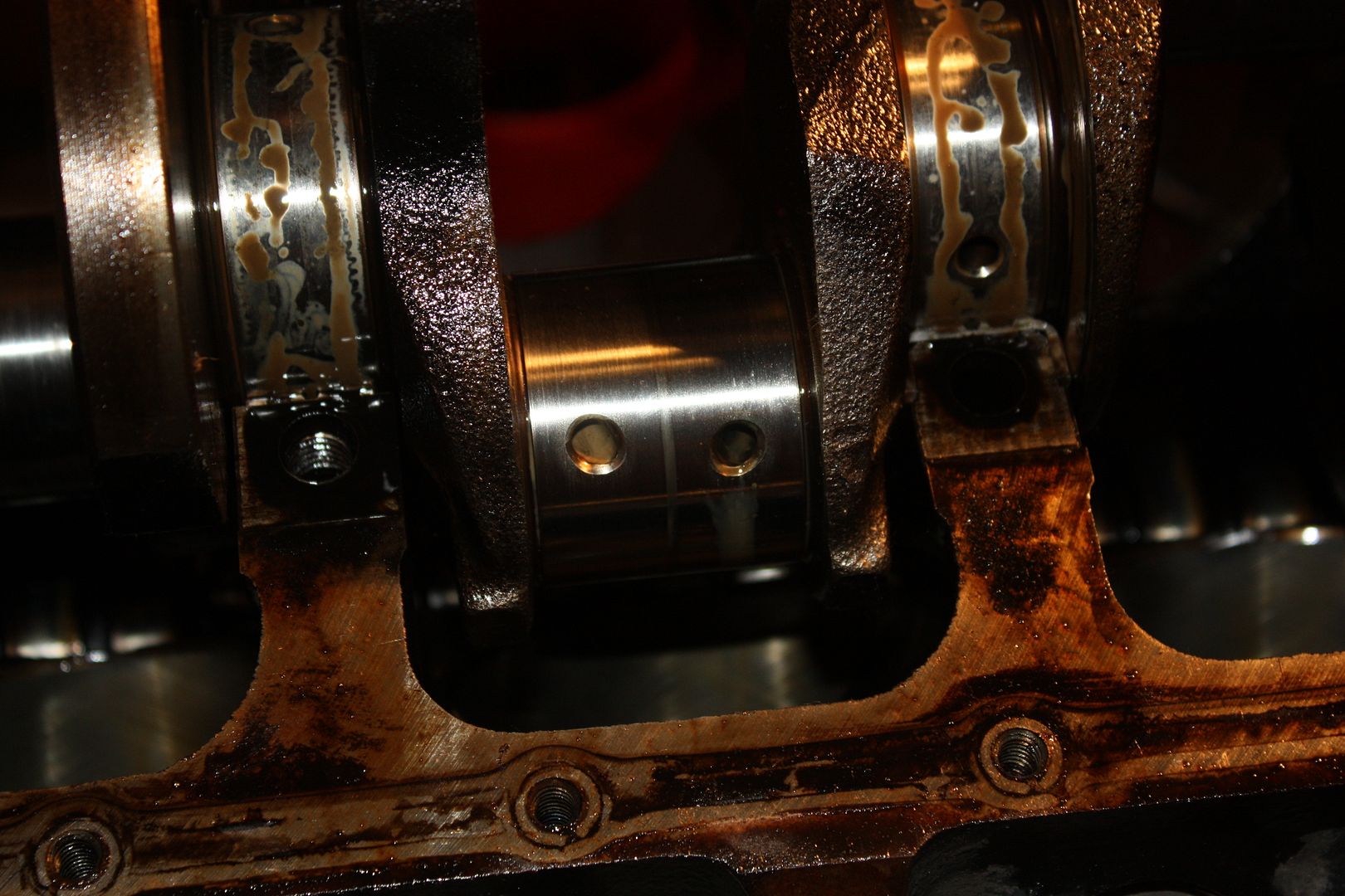

Crank journals all look good.

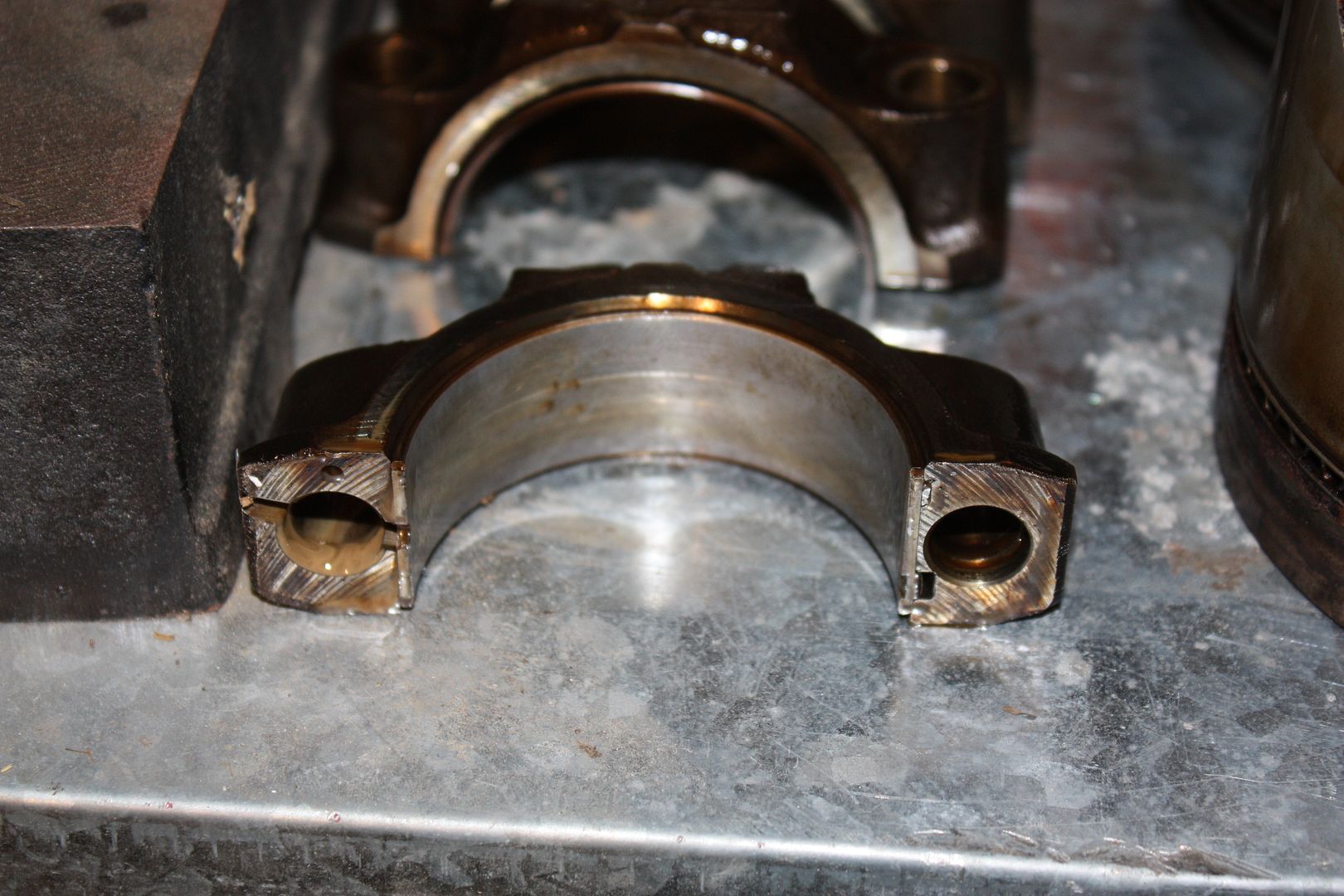

This bearing came off #2 hole and is the worst looking one.

My improvised valve train holder.
Parts all lind up and ready to be cleaned.
