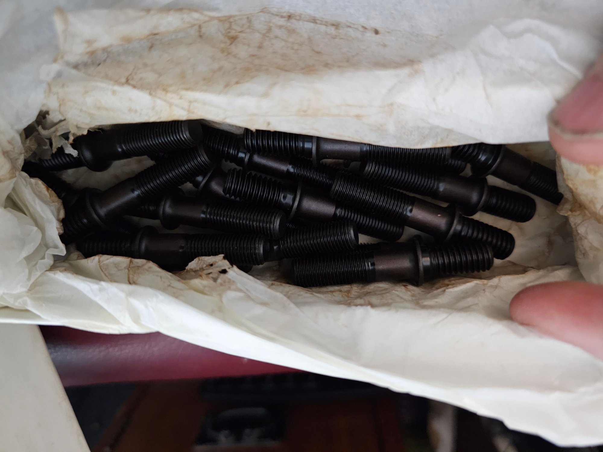

The rocker arm studs ended up arriving on Friday as originally scheduled so not sure what happened.. These are some NOS items. I'm wondering how many of these do they still have left on the shelves?
They look just like what came in the Crane kit....
Got a tracking number from HiPoTek already and they will be here Thursday. Funniest part is that they are being shipped from Hughes Engines....
Hopefully once I have the Jeep running & driving then I can get my motorhome fixed and I'll be able to snowbird and head south during these cold months.

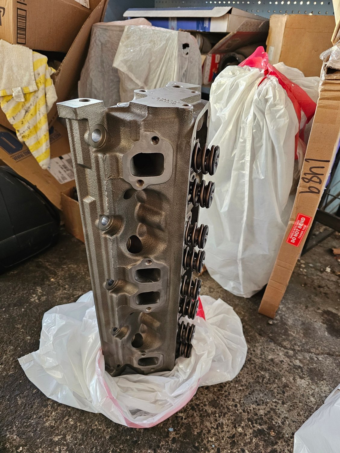

Old Feb 2, 2024 | 12:09 AM
  #1187
Wildman4x4nut's Avatar
Wildman4x4nut
Veteran: Army
Joined: Nov 2011
Posts: 1,898
Likes: 162
From: Cle Elum, WA

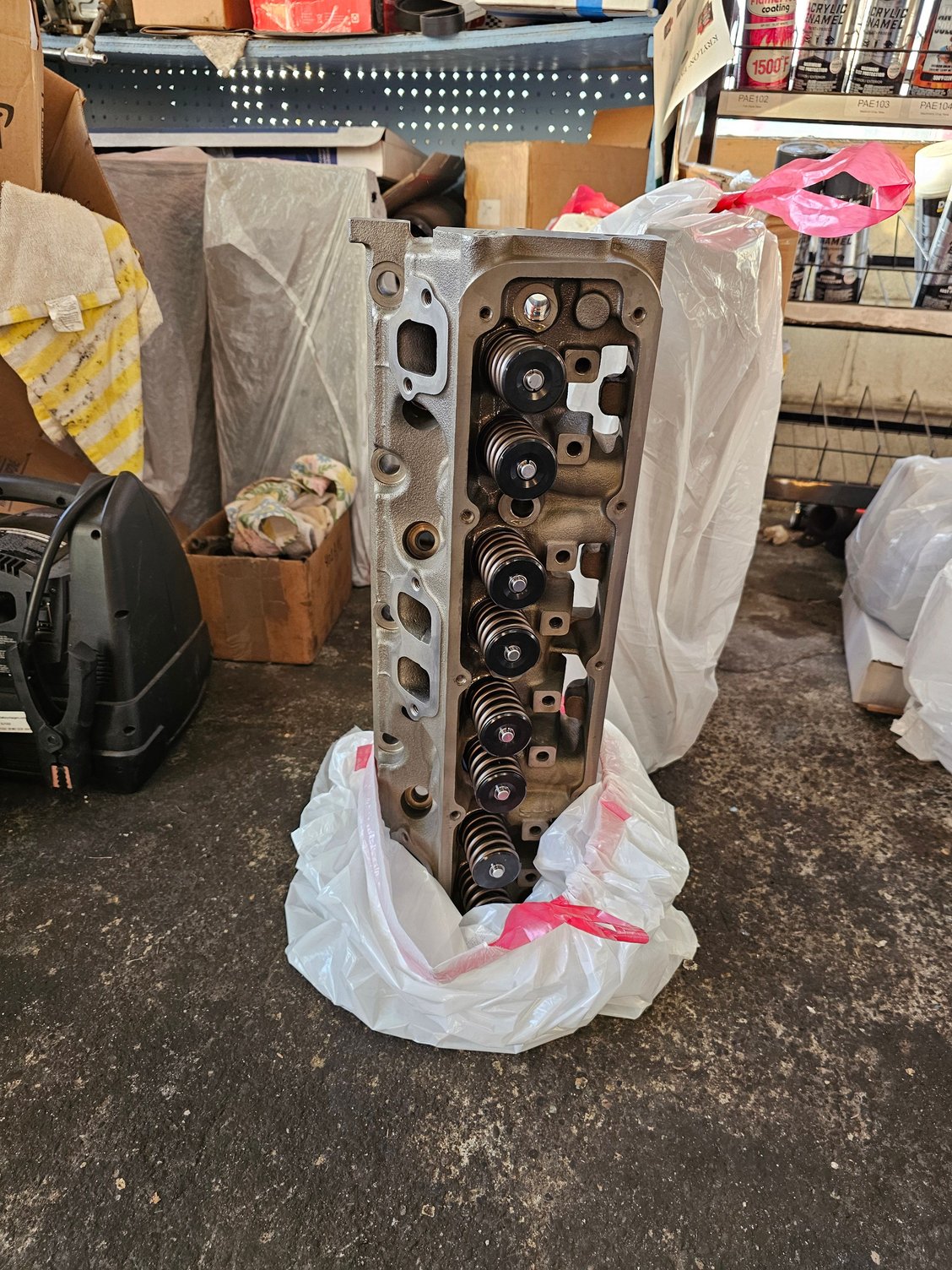

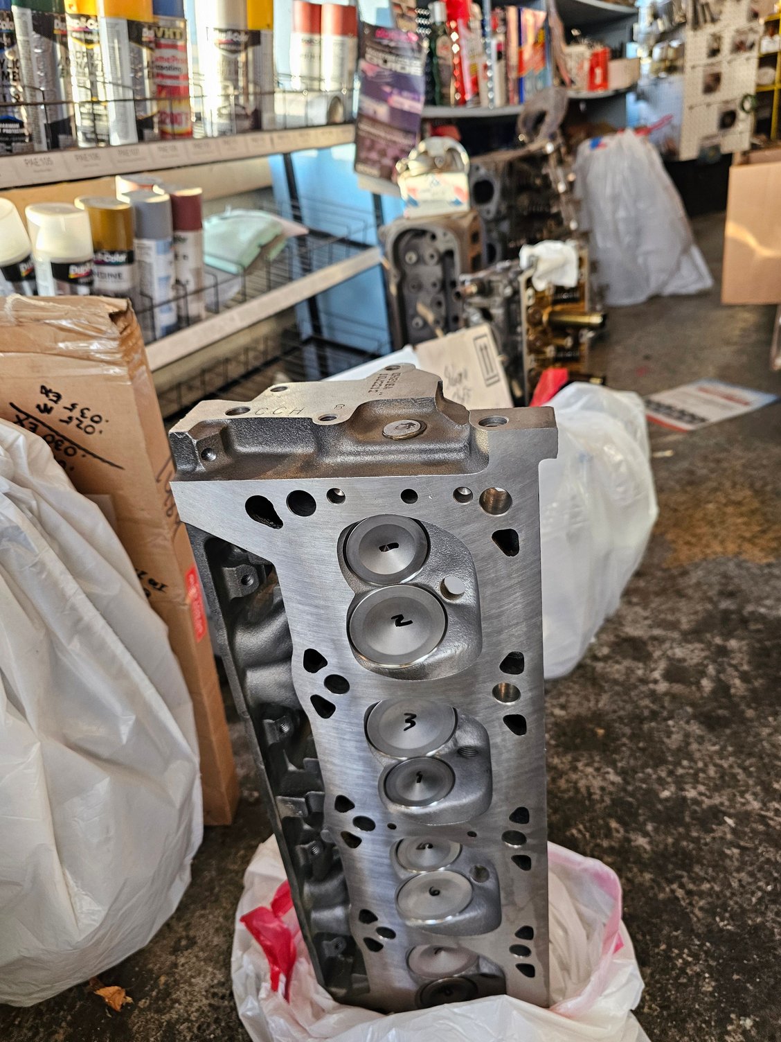

Repaired heads are back finally from the machine shop. Yahooo...
I've got an appointment tomorrow in Seattle so won't work on the Jeep until the weekend.

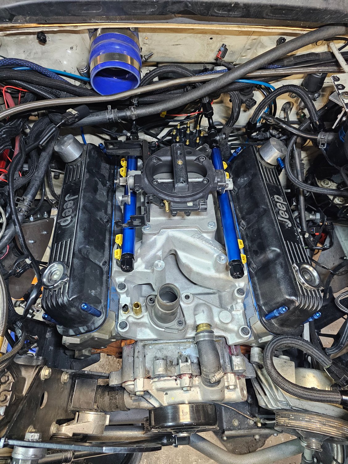

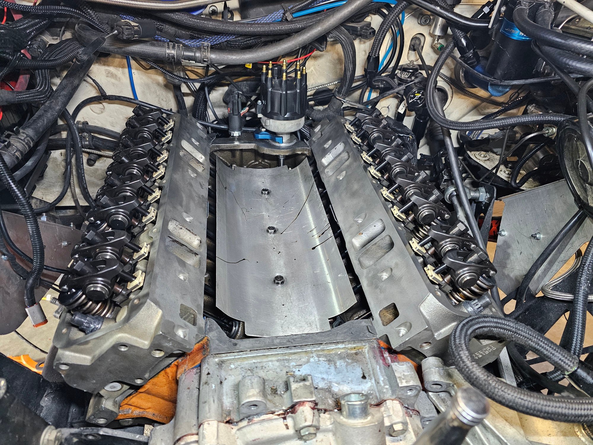

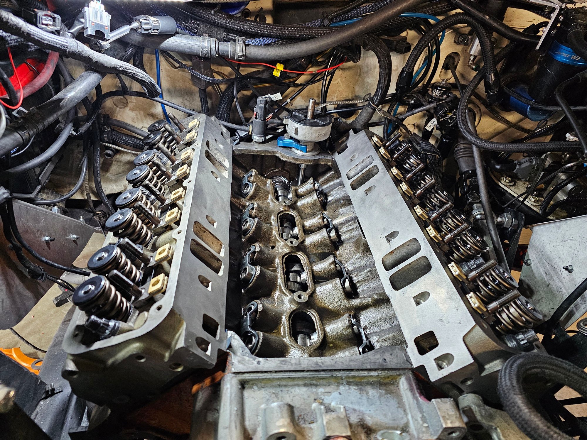

Problems seem to just keep following me around. I got the heads back onto the engine and put the intake back on.
I must be getting OLD because I managed to mess up my shoulder while putting the heads on. So I ended up having to take 2 weeks off from working on the Jeep.
I installed a new distributor cap & rotor and new plug wires to try and eliminate any & all things that might have been wrong before.
I got the gaskets installed and then set the intake onto the engine.

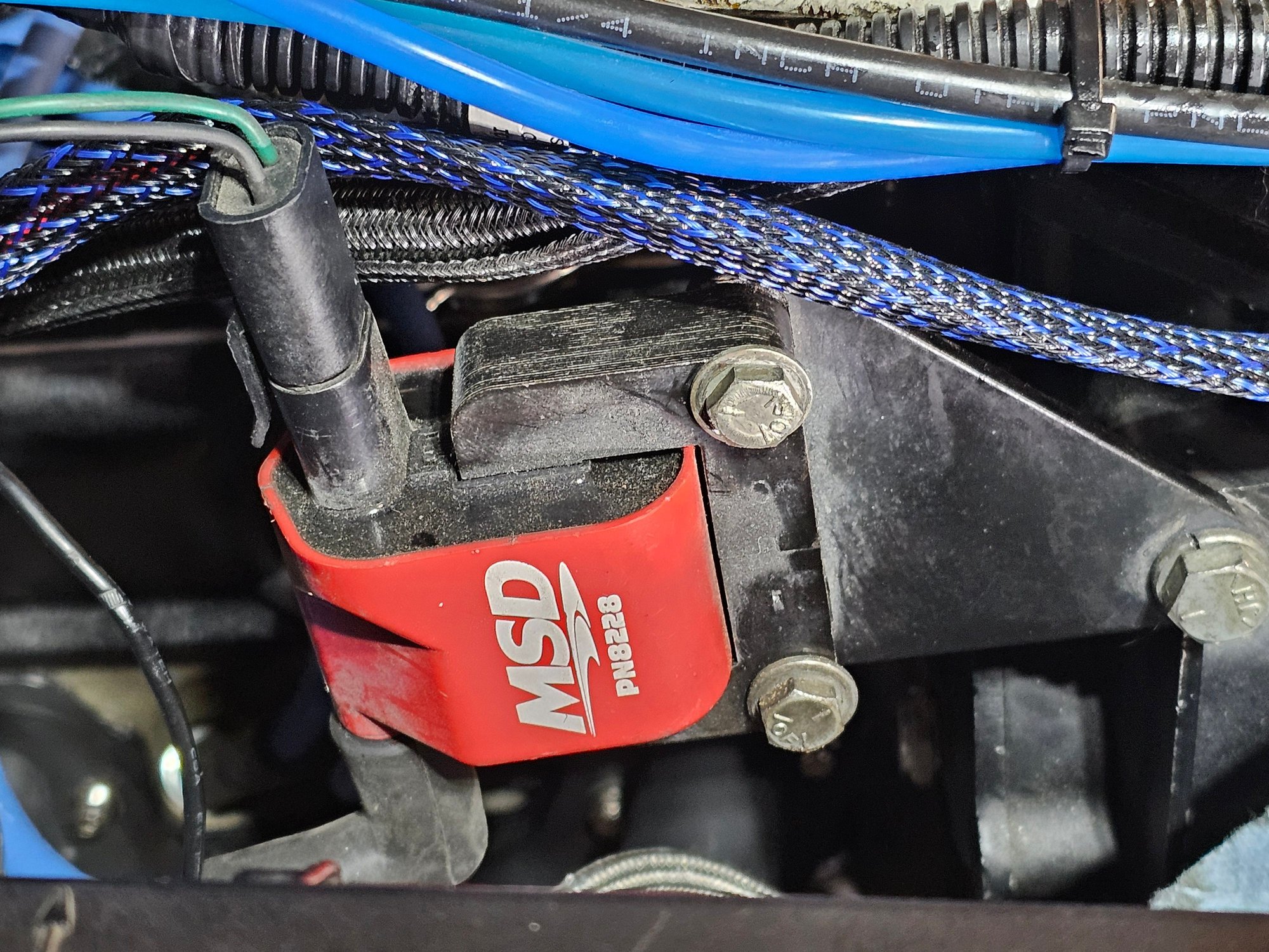

But once I got it running again I am still having the low oil pressure issue once the engine is warmed up. I'd really hoped that I'd messed up the install on the head gaskets prior to this time or something that had caused the low oil pressure. Also when I went to start it for the first time the engine wouldn't start. Traced it down to a SPARK problem & identified it as the coil being the problem. Luckily I had a spare coil on hand and swapped them out and boom started up.
The Screamin Demon coil is 15+ years old. I don't know the history on the MSD coil so I ordered a Accel coil to have on hand.
It runs but not like I'd hoped and I still have cylinders that are running hotter than others. I have all new Acell 32lb injectors installed now also.
So I'm going to pull the engine back out and replace the main & rod bearings to see if that will fix my low oil pressure issue.
Now when I was assembling the engine I'd made sure to clean out all the oil passages prior to assembly but I'm guessing I must have missed something? So my question for all of you now is that if I'd missed something and it was enough to wipe out the bearings could it/would it be enough to also have taken out the crank? Meaning do I just throw bearings at it or? I don't think I have a micrometer large enough to check the mains & rod journals so can I get an accurate enough measurement with a caliper? I'd also planned on plasti gauge it but would like to do more if possible. What else should I be checking or doing while I have it apart? I hate the idea of having to pull the engine but I can't replace the bearings with it in the Jeep.
