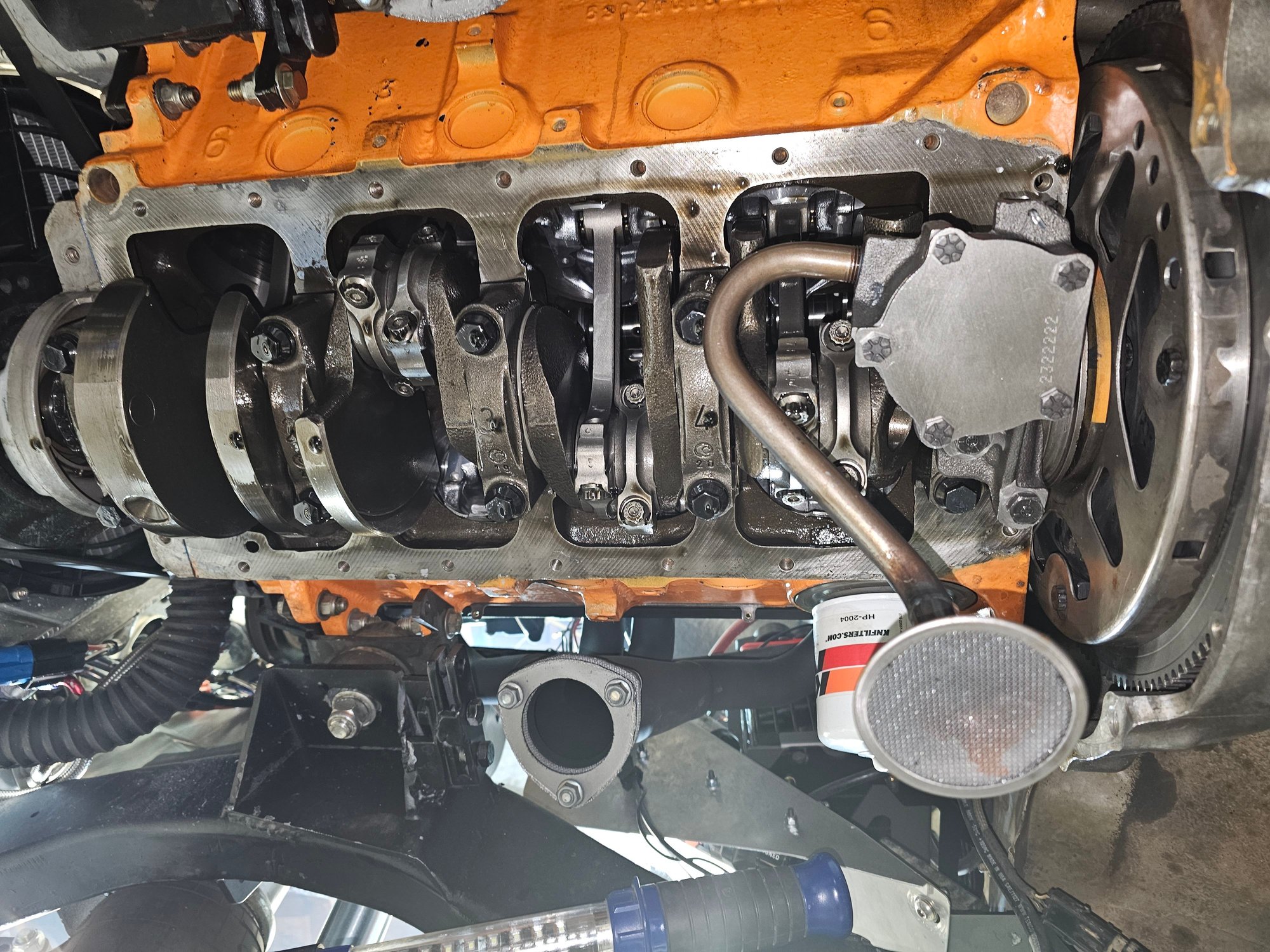

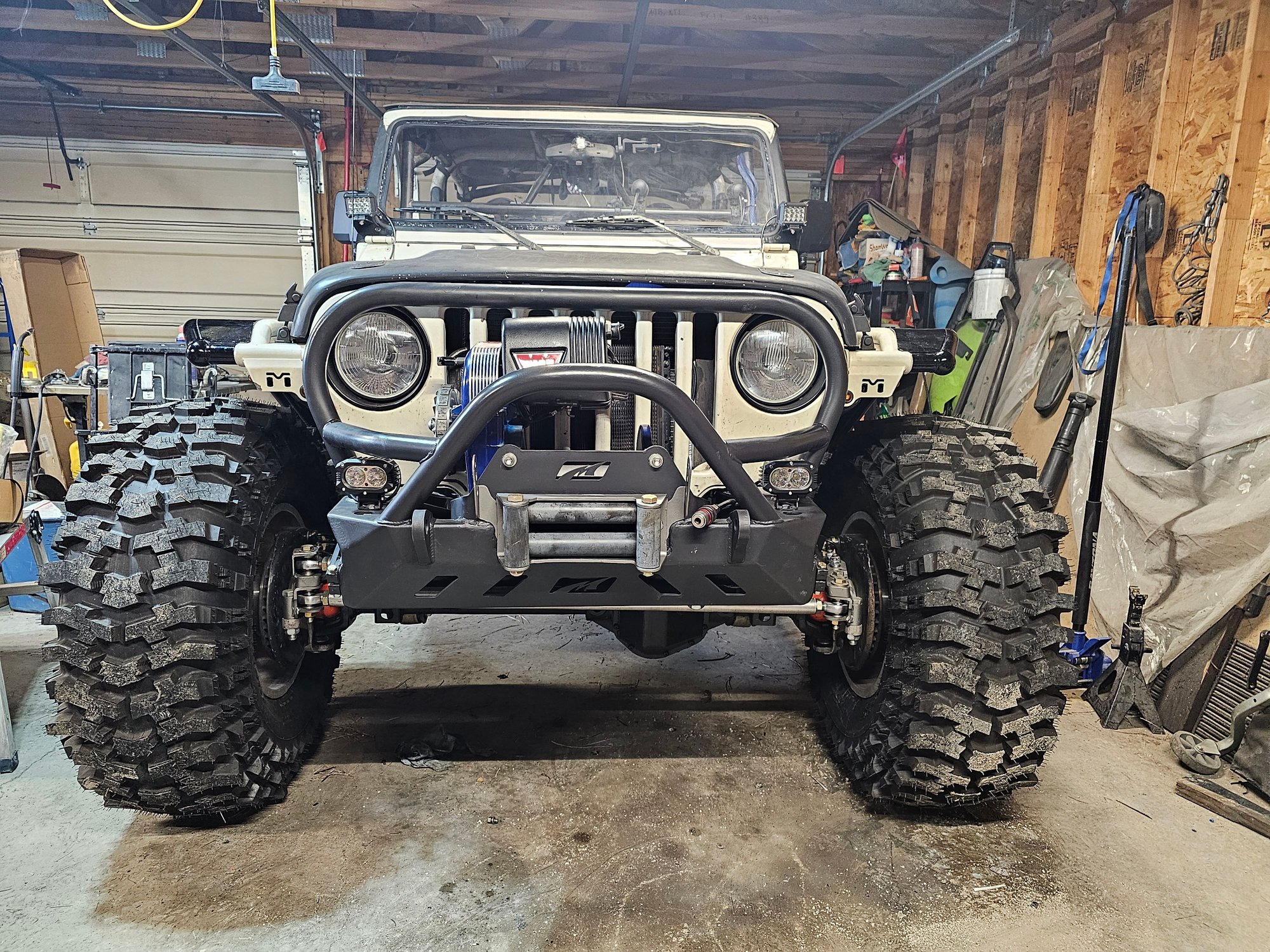

A just because picture.... Dang it looks good.
New oil pump & oil pan gasket & 2 gallons of break in oil arrived around 4PM today.

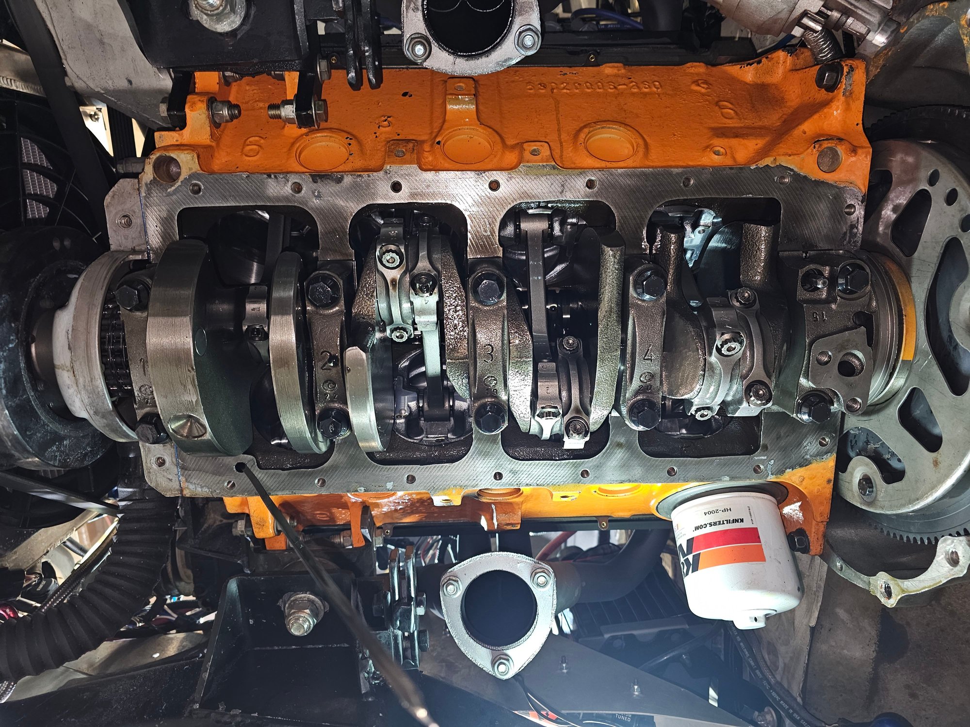

Dropped the exhaust and then the oil pan. Removed the old oil pump but didn't take it apart yet. But I did verify that it was a high volume oil pump which I guess was the wrong pump from what I'd read.
Installed the new oil pump but will wait until tomorrow morning to install the oil pan. Once I have that done I'm going to try out a new exhaust setup.

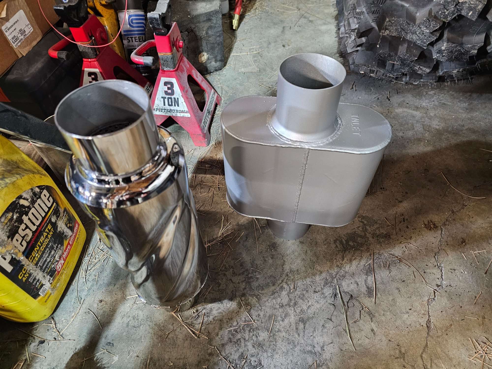

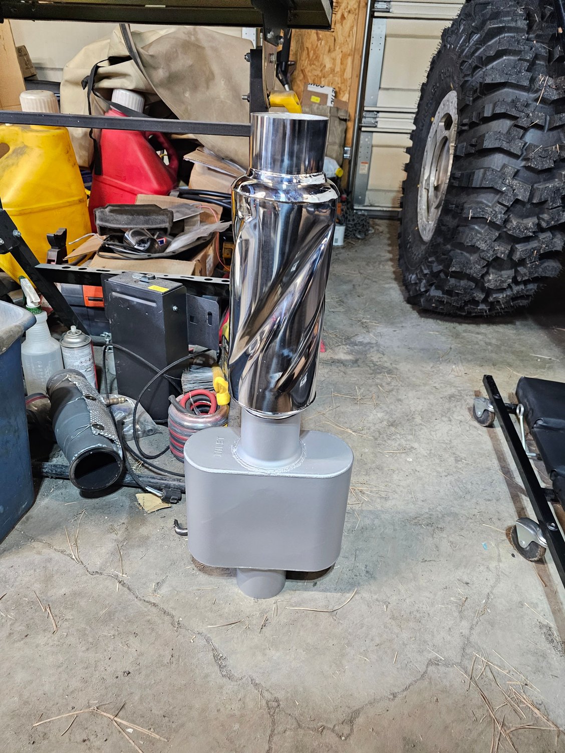

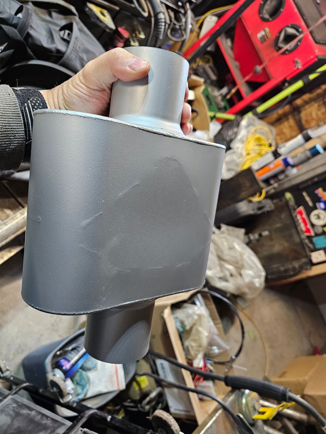

The exhaust note is still too loud for my tastes so I'm going to try something else. Since I'd pushed the rear axle back 5" I didn't have room for a tailpipe to exit the rear like it does stock. So I'm going to try combining these two muffler to see it will quiet the exhaust down just a little bit more.

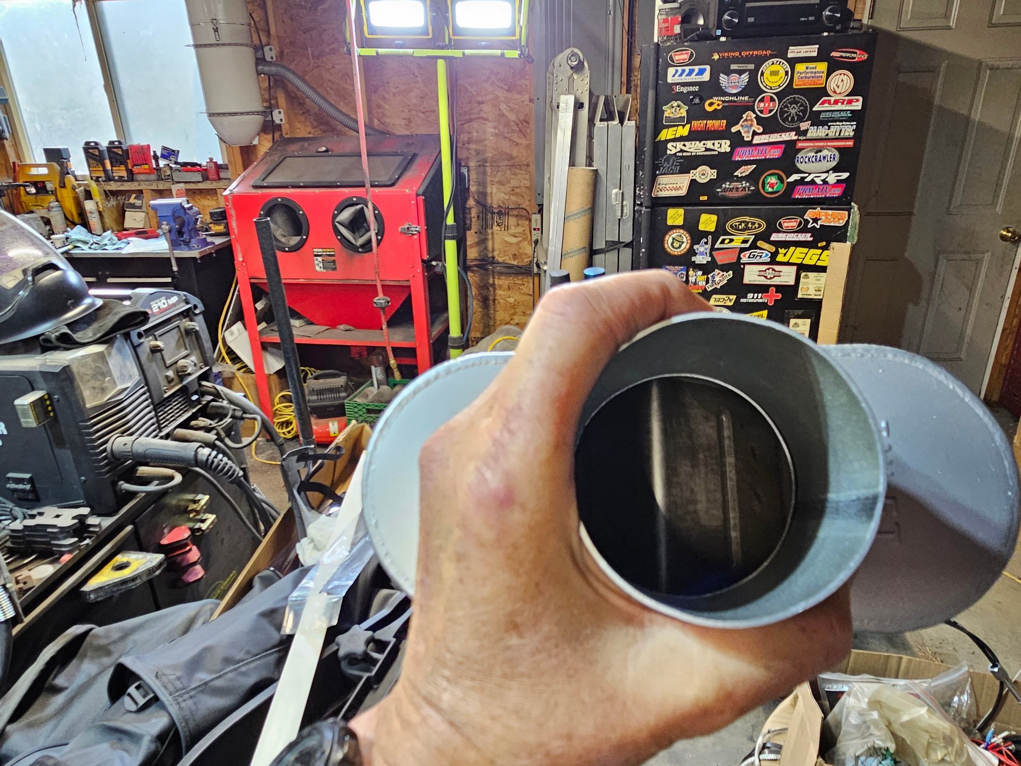

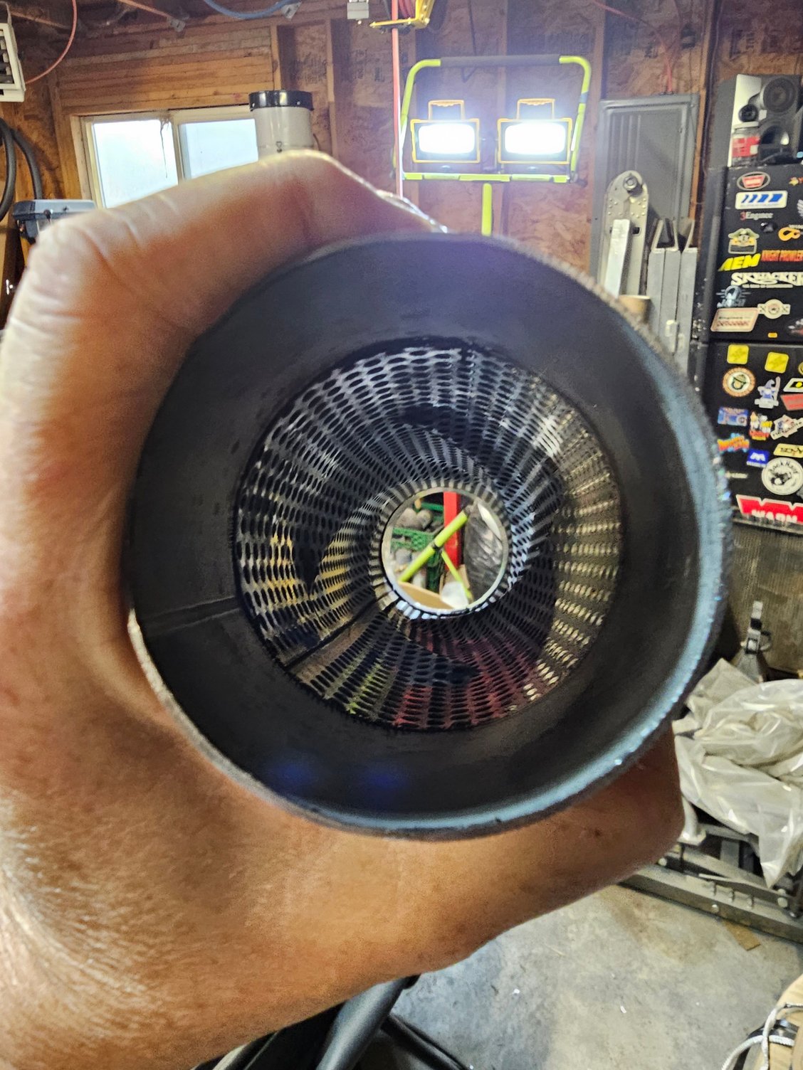

The round exhaust has a spiral inside they claim helps to reduce the exhaust sound.
This is a single chamber muffler but it's about a larger as I can fit under the Jeep.
My idea is to put the two of them together and see if it helps.

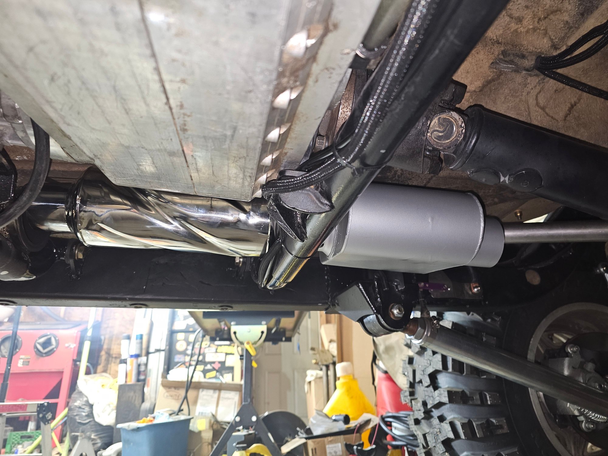

It would sit under the Jeep approximately like this.
I don't have a lot of room under the Jeep.

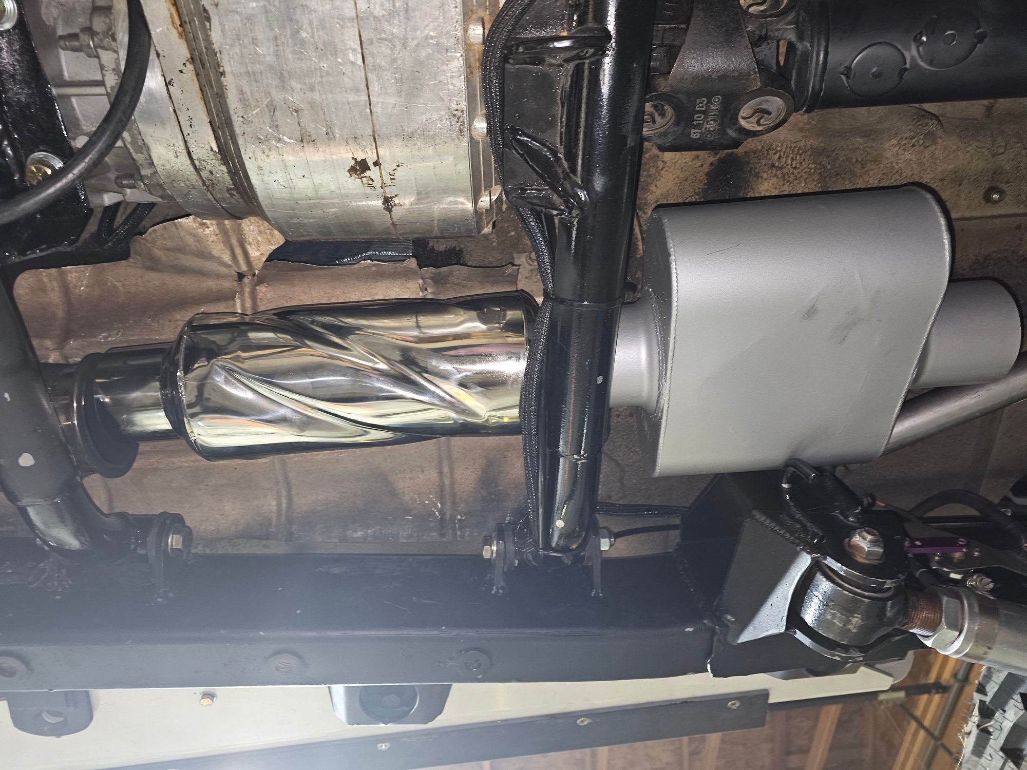

New exhaust note...
