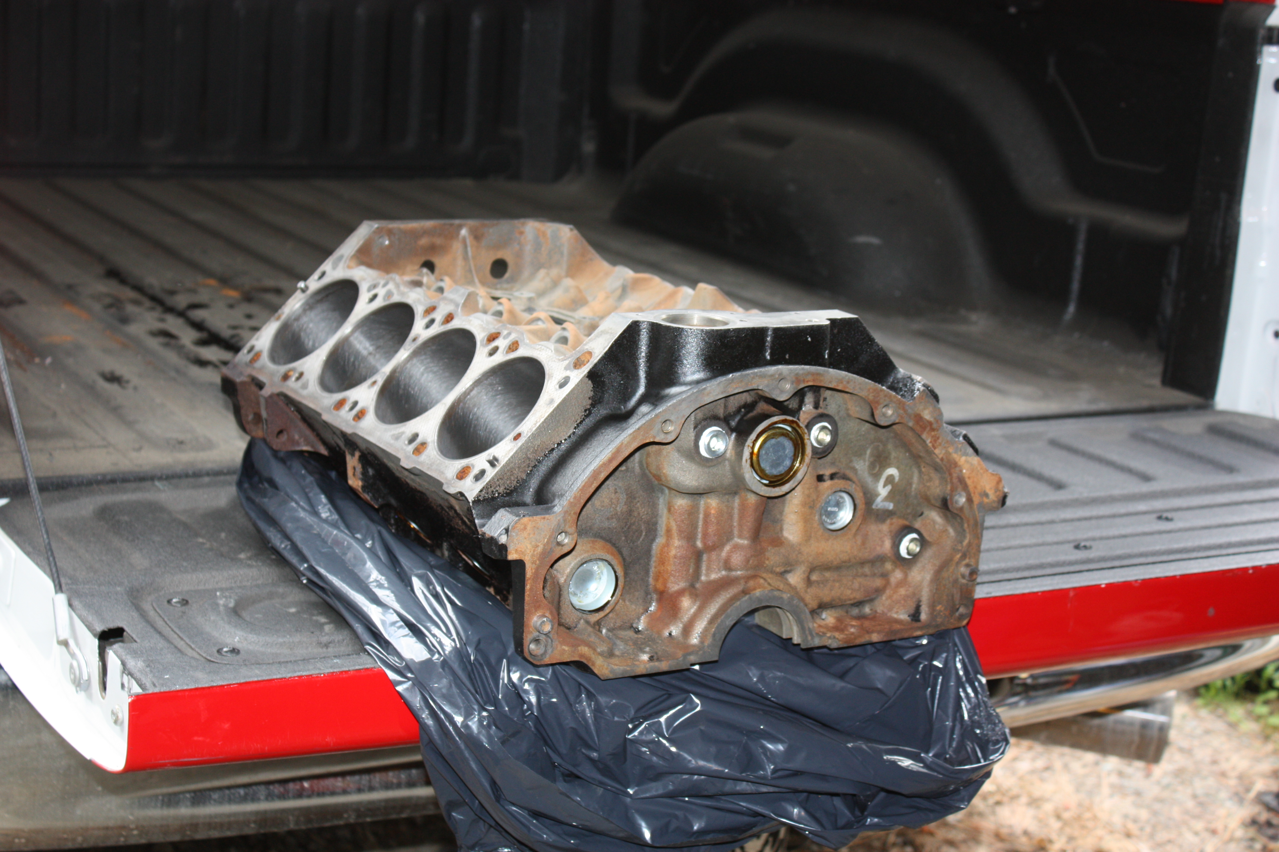

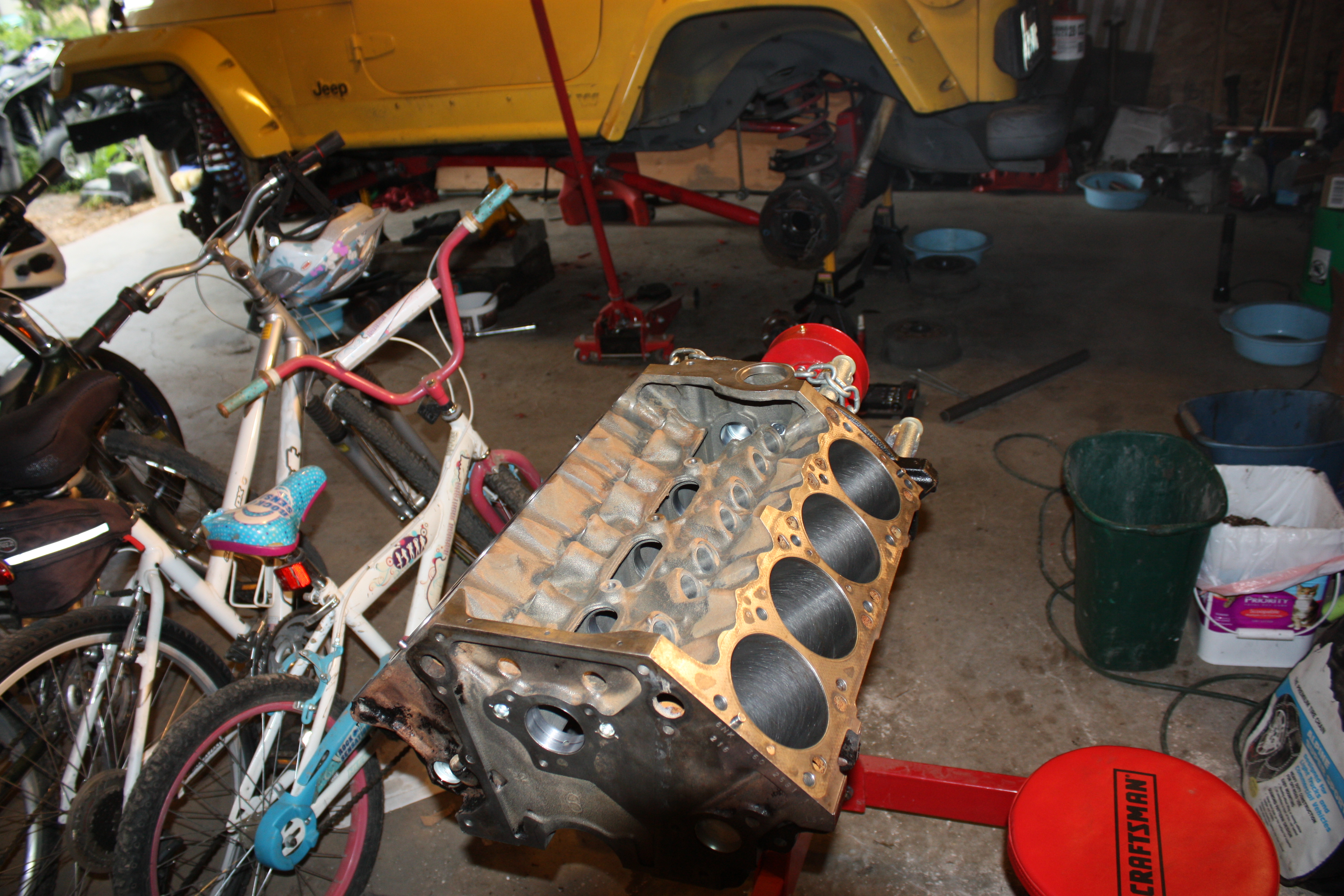

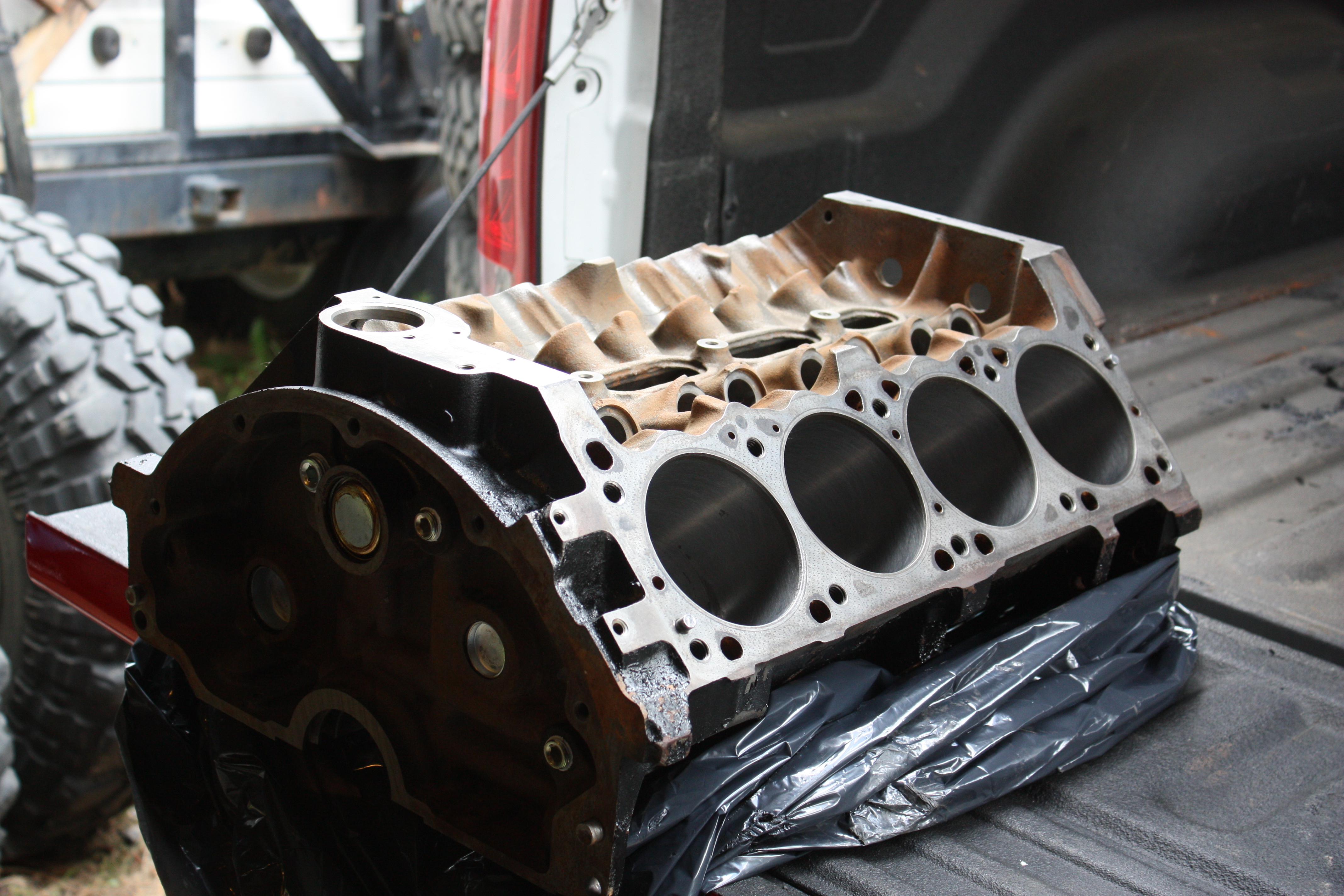

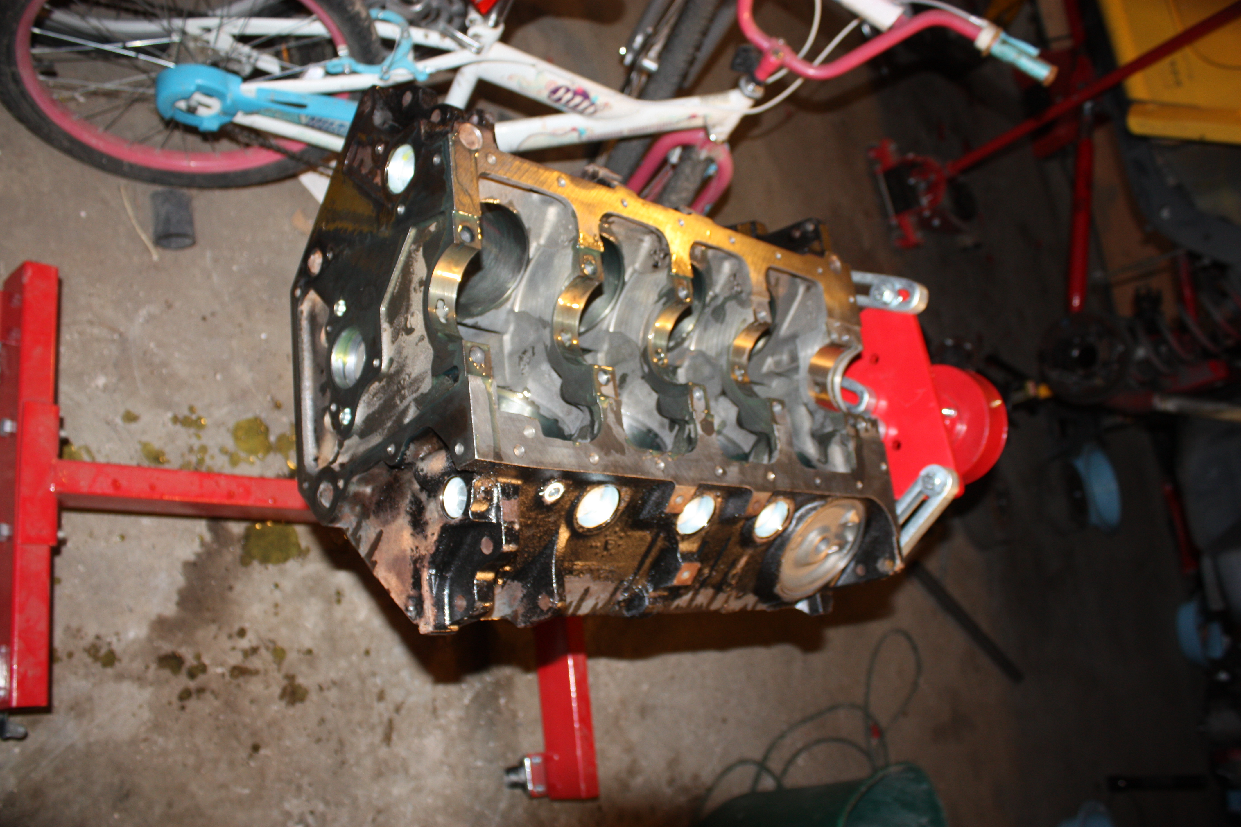

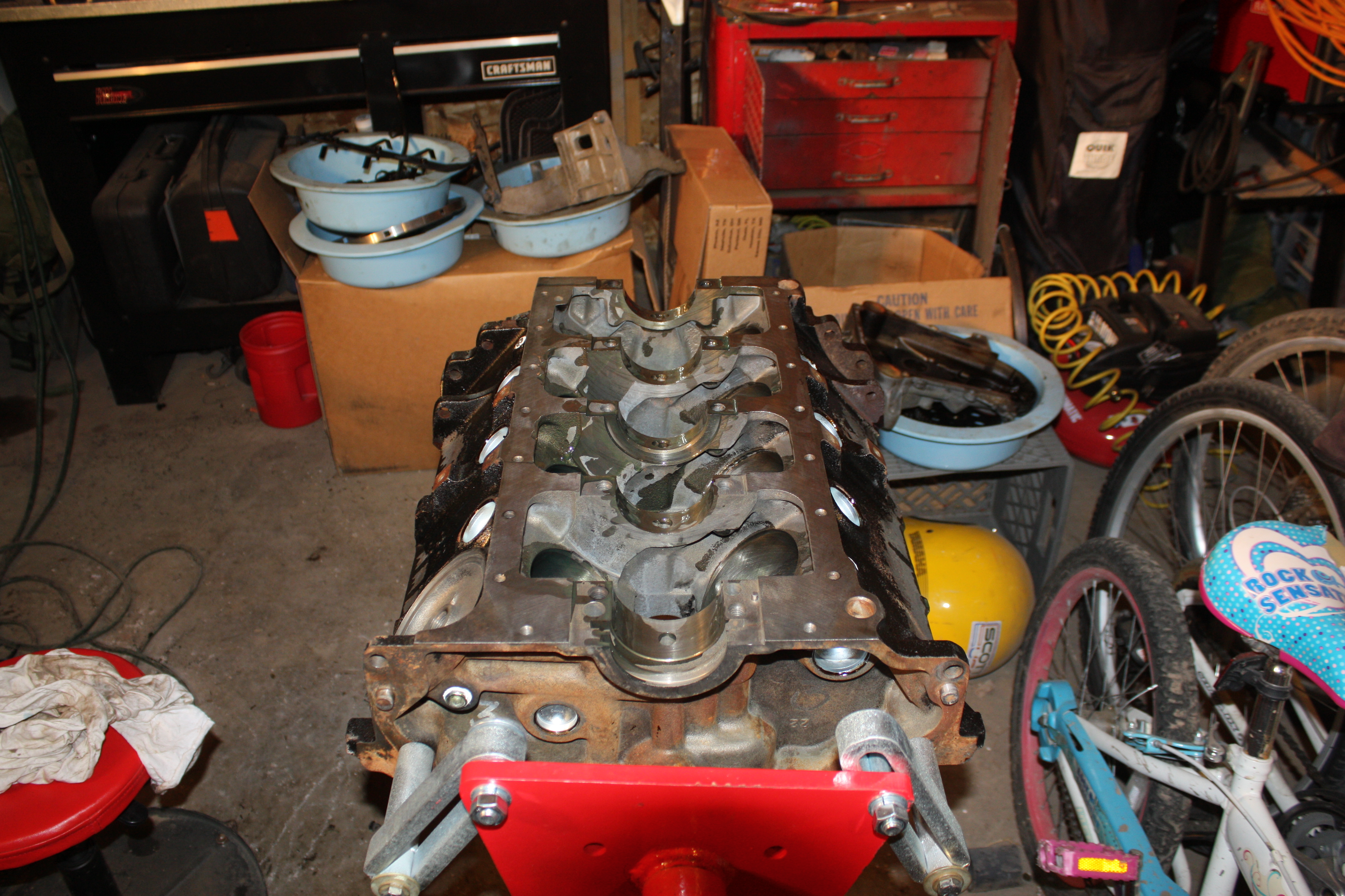

So I got the engine home yesterday and mounted it onto my new engine stand. It is the crank type stand so I don't have to roll the engine over like before. Much nicer to work on and a lot easier.
HeyYou,
Used some 90wt oil I had laying around a covered the cylinders and all bare metal.

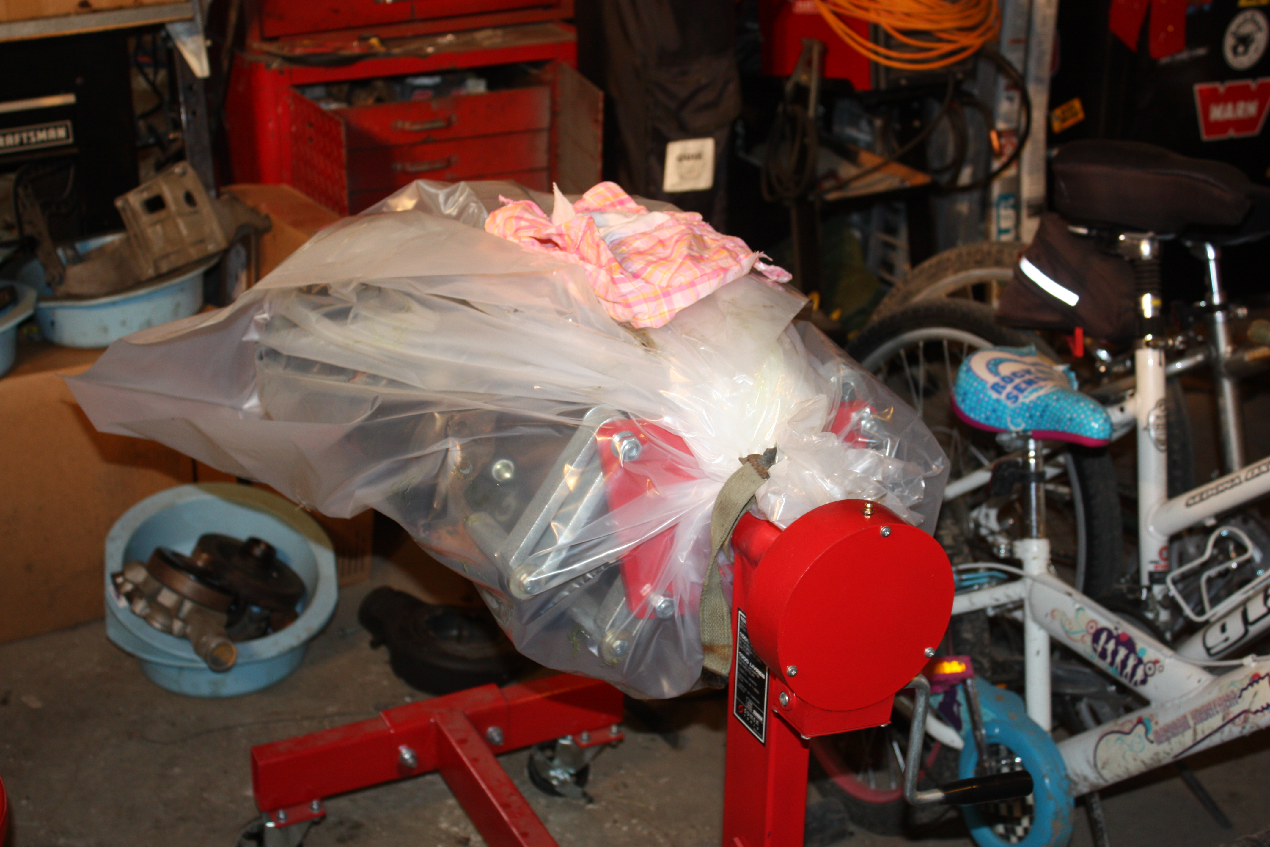

In the storage bag waiting for me to have time to work on it.
My question now is: Do I wait until I get back home in Aug to put the engine back together or Do I start on it now and get as far as I can before I leave on vacation for 6 weeks? The rods, pistons, crank, lifters and parts taken off engine are not covered. They are all just sitting on my work bench or in little tubs for storage.

If you can get to a good stopping point on the re-assembly then I say go for it... It'll also give you a heads up in case something doesn't go together quite right...

I always used gun oil for protecting fresh metal parts. It's light and easy to apply. If it can protect our Nation's firearms...it can protect engine components. LOL.
I would say jump in and start building. At least get the main bearings in, crank seated and tolerances checked. Get the mains torqued and make sure everything still spins smooth. If not, this way, you can get the block dropped back off to have any wrongs corrected.
If you still have time after that, start installing your pistons. It'd be nice to have your short block completed before you leave. I know that would make me happy if I knew I was going to be gone for a while.

Yeah, the more critical surfaces you can get protected by being installed, the better. Six weeks is a long time for those parts to be sitting out. You will have serious corrosion issues if you wait.
