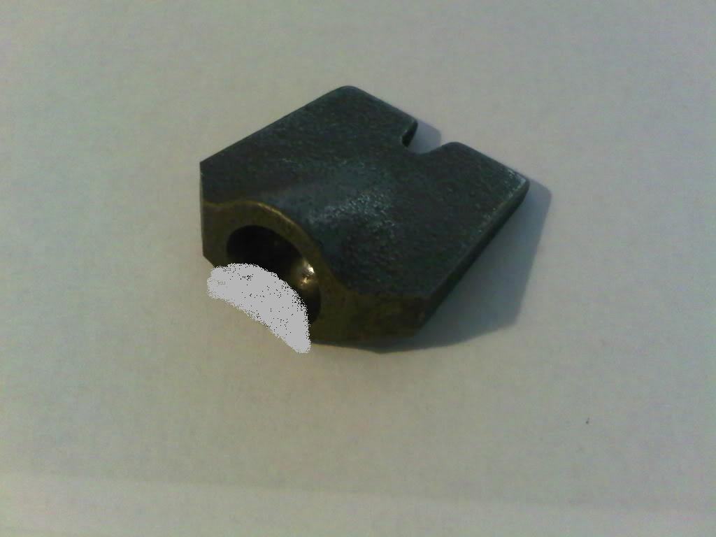

Can you post pics of the broken parts?
Download the 01 service manual from the faq section here. (yeah, it's for ram trucks, but, you have the same 46RE trans the trucks do.) That will show ya where everything goes, and also have a nice detailed step-by-step for doing a trans R&R.

Does it looke like this? (anchor)
Or this: (strut)
And I cannot envison the band breaking. They can wear, but I have never seen a band break in any transmission at all.

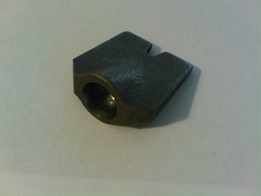

Default here is a edited picture of the broken band strut...
Here a edited picture of the broken band strut, is it possible to install a new one without dropping the valve body, and can i do this with the tranny on the vehicle?
thanks for any help.

Yep, get a new one, and put stuff back together, no need to drop trans, or valve body.
Dodge Kickdown Band Anchor #03743338. Is it broken? How and where?
