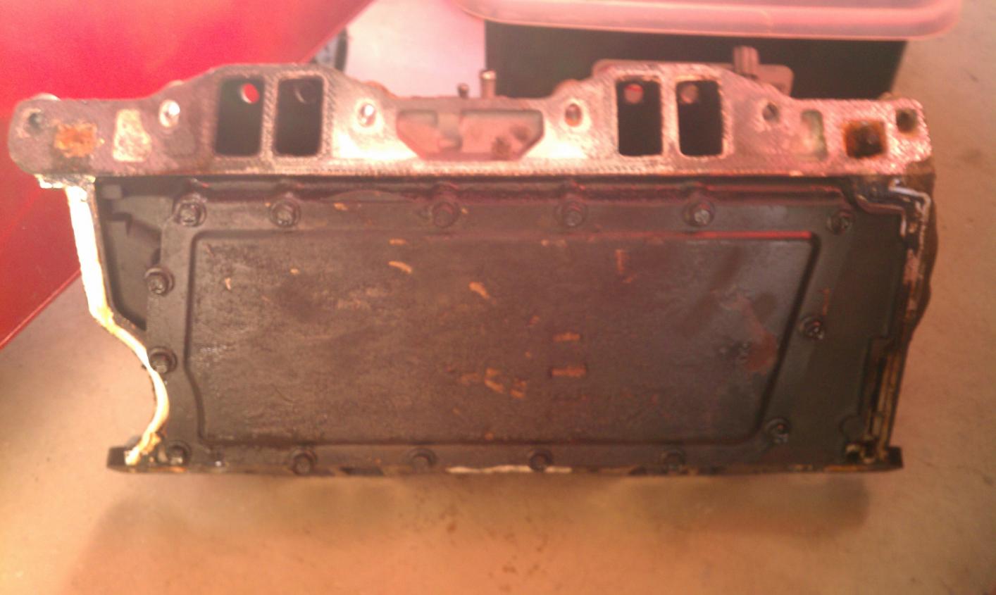

looks like my guess was right and plenum gasket needs to be replaced. Between this and the little tune up I'm giving it while it's apart I ought to have a race truck now!
